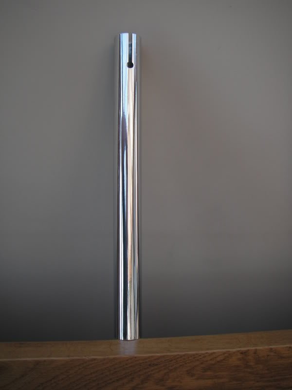

what the hell have i done ,got  a looptail ripper as a rider and i have broken the seat post.i know its a
common place for them to break but i am gutted,can it be fixed and still be usable,or does it have to go to se racing
heaven,has anyone experienced this,please help.

how mashed is it ??
a decent Aluminum welder should be able to sort it
a few of the members on here have fixed em too, if it needs a complete new seat tube then there was someone selling em on here, can't recall the name of em???

i had a look at that one nice work,has anybody had the work done on thier pk,
is it worth just getting the top rewelded,or going for the whole seatpost tube.

« Reply #4 on: May 04, 2007, 10:40 AM »
it would be cheaper to get just the top welded if you can get away with it ? mine just had a hairline crack which i got rewelded perfectly for a tenner, but it was done as a favour  ;)

i had a new tube welded into mine and was spot on

it would make a much better repair if you get the whole post welded in,speek to donker he makes the posts they are top quality, :daumenhoch:

I have replacment tubes if you need one, then you just need to find a welder or use one recomended on here.
