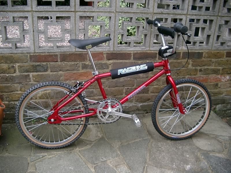

Offline stuntmaster
  • Posts: 2529
Re: candy colours, sure their not metalics
« Reply #17 on: May 25, 2007, 11:19 PM »
i speak to my mate as he did my raceinc that is metal flake and came out excellant see here
no1stuntmaster on instagram
darkersomeday
« Reply #18 on: May 25, 2007, 11:32 PM »
see, no offence but i'd disagree,
thats closer to the standard bykes "metallic" finish,
these two are what would normally be termed "metal flake" , you can see how the flakes are larger and brighter making the finish/effect sparkle or "pop" more,
but where does the "candy apple" come into it all?
i've dug out pics of the hutch and standard colours for comparison, i'll post them up,
