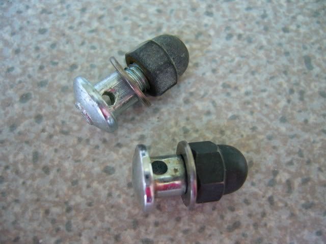

Behind the tab you should see a nut... and the bolt that that's attached to should have a hole in it to thread the cable through... tighten the nut to fix in position. Same principle as your convetional brake... hope this of some help.
othomas2
Re: DiaCompe 901 fitting
« Reply #4 on: June 19, 2007, 11:08 AM »
You should have something that looks like this running through the quick release mechanism. The hole i where the cables runs through...
