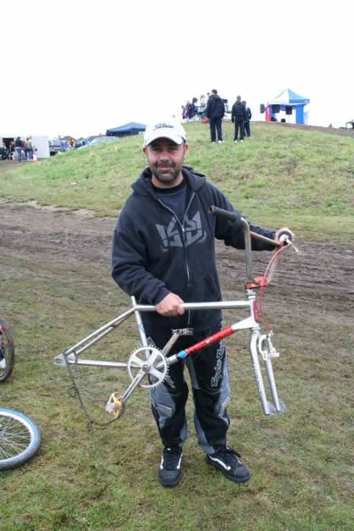

Back in 1981 I raced with a guy called Tony Slater, he went on to become one of the first pro racers in the UK, and recently he has started racing again, we have a laugh and joke about our old bikes, he told me months ago he still had his carrerra in the shed!! Well he dug it out today and brought it down for us to see. Flites, pro neck stem , one DX and one XC2 pedal :shocked: and Gt bars. Tony is racing at the British Championships next week and was going to try and restore it in time. Maybe 2008 Tone :daumenhoch:
l

great story, ratty. i love hearing about one owner survivors  :smitten:
i wish i still had my old prolineII from back in '82  :'(
Re: Redline Proline II
« Reply #292 on: August 21, 2007, 06:01 PM »
Cool story Ratty :daumenhoch:
