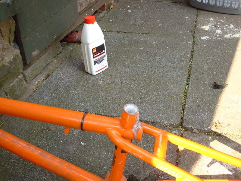

cool ,the posts are the best challenge.if its alloy costic soda will disolve it all out.

bung up the holes if there are any....
it take about 6 refills with a good strong mix.

that caustic soda shit scares me! i'll be honest!
how long does it take to eat the alloy?
why doesnt it affect the steel?
were going to have a look at pulling it tonight, i'm drilling a hole in the top f the post to put a bar through,
i thought about roping the frame to something solid and putting the winch on it! the risk of tearing the frame apart isnt worth it though :LolLolLolLol:
its been soaking in diesel all night so.....
,,,, i'll let you know how we go on :daumenhoch:

the costic is quit fast and easy to use ,and doesnt affect the steel.just dont inhale or get hear your eyes
drill out as much as poss it will speed up the job.

with a quite large great fook off vice, and me stood on the bench its finally let go :knuppel2:
