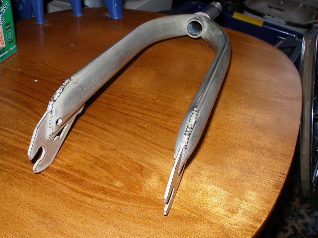

WENT FOR THE BLOW LAMP  ( 9.99 FROM WILKOS) AND SOME NITROMORES, JUST DONE THE FORKS, TOOK BOUT AN HOUR, TAKE A PEEK  ::)

cushty
