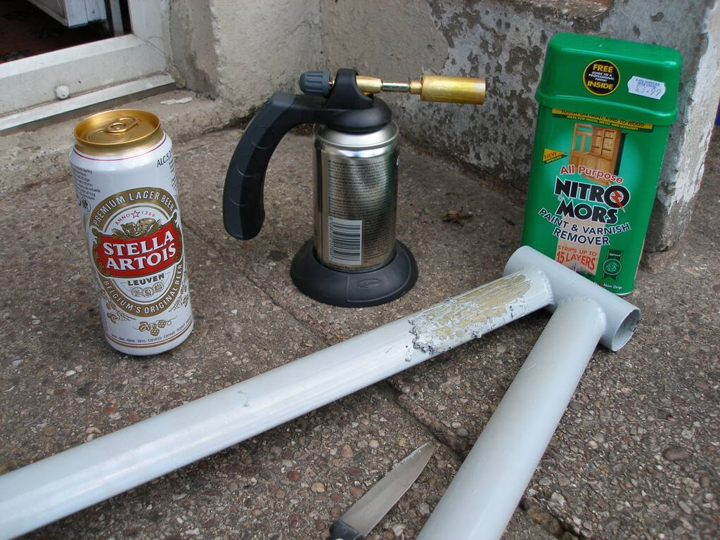

THIS IS MY SATURDAY PLANNED  :(...........
darkersomeday
Re: HERE WE GO AGAIN..........
« Reply #1 on: July 14, 2007, 11:49 AM »
nice,
the lovely mors.........
those wire pan scourers are the best thing i've ever used :daumenhoch:
put the blow torch away too :LolLolLolLol:

ill nip to the shop n get some, are they the ones that have the pink powder soap in em'? ohhh, the blow torch, the misses wants to use it for ' browning meringue's ,  :LolLolLolLol:
darkersomeday
« Reply #3 on: July 14, 2007, 12:04 PM »
no dude, not the ones with the pink gunk in them,
1 sec, i'll show you :LolLolLolLol:

wire wool will work but these are the best i've found,

its my favourite part of restoring something, seeing whats under the paint :LolLolLolLol:
i find it easiest to dab a good coat of the lovely mors on then leave it for ten minutes, then put another nice coat on and leave again,she should bubble up a treat :daumenhoch:

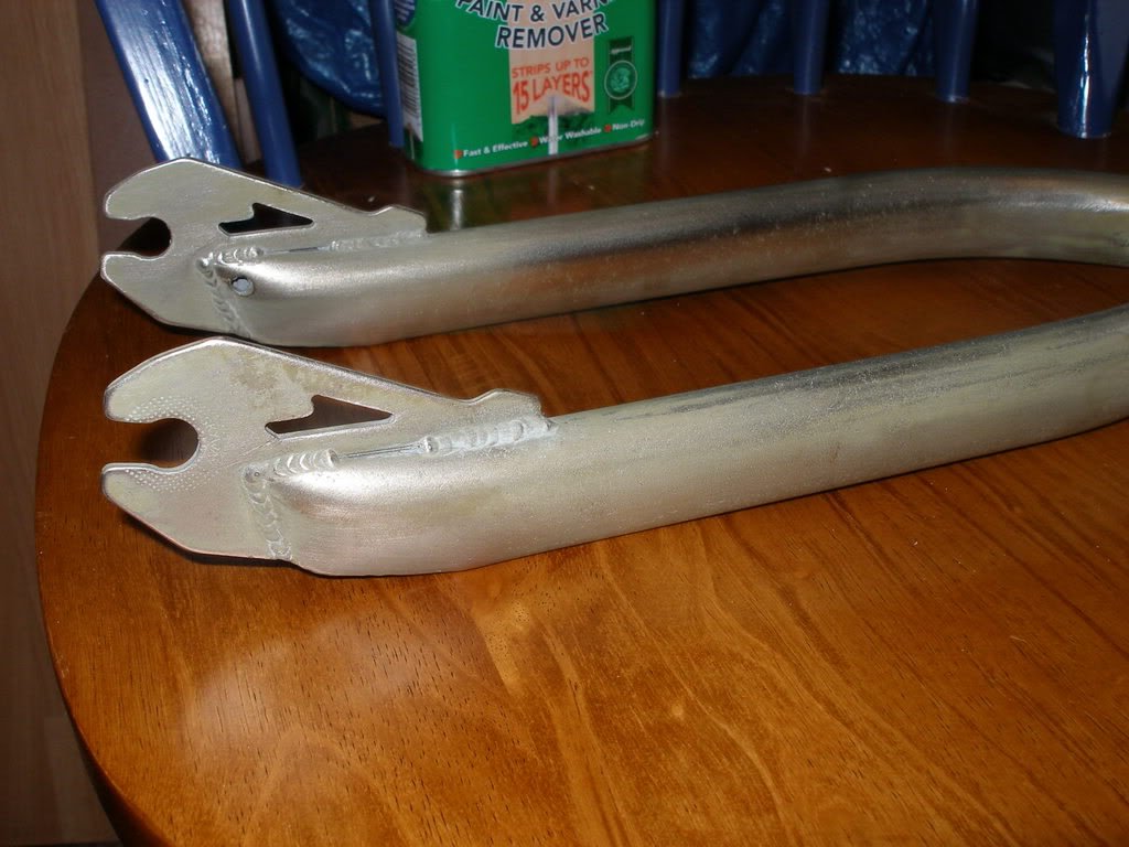

YES MATE , POWDERED WHITE, 84 TA US BUILT, MORE PICS...........
darkersomeday
« Reply #9 on: July 14, 2007, 01:02 PM »
she's bubbling away nicely :LolLolLolLol:
nice job on the forks dude :daumenhoch:

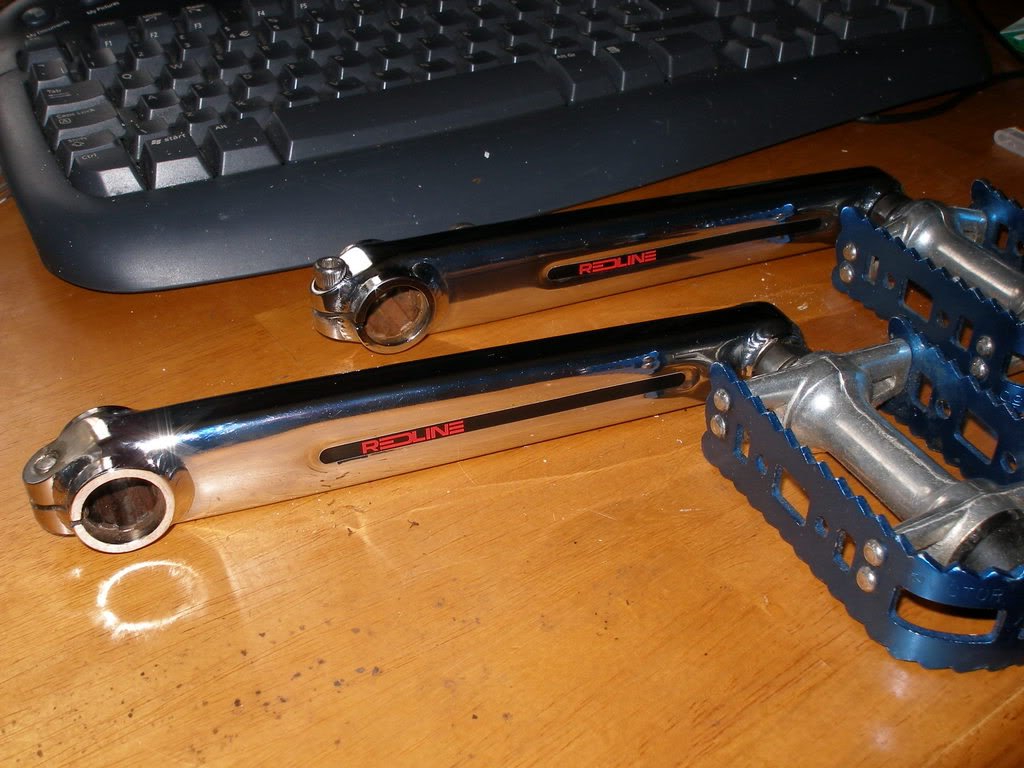

CHECK THESE RECHROMED BABIES....... :)
« Reply #14 on: July 14, 2007, 01:35 PM »
Cranks have come up well  :daumenhoch:

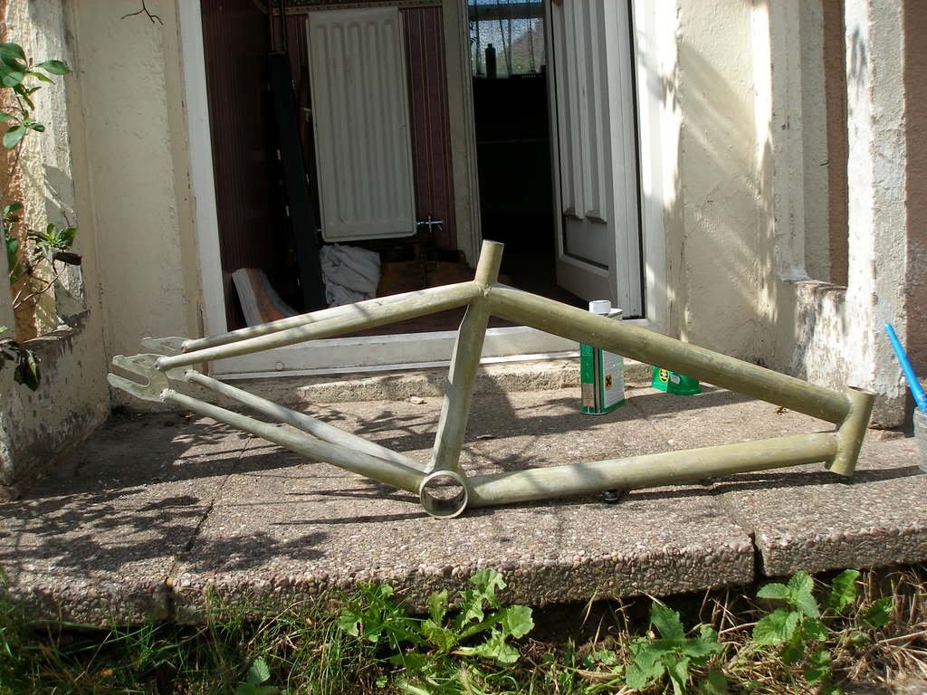

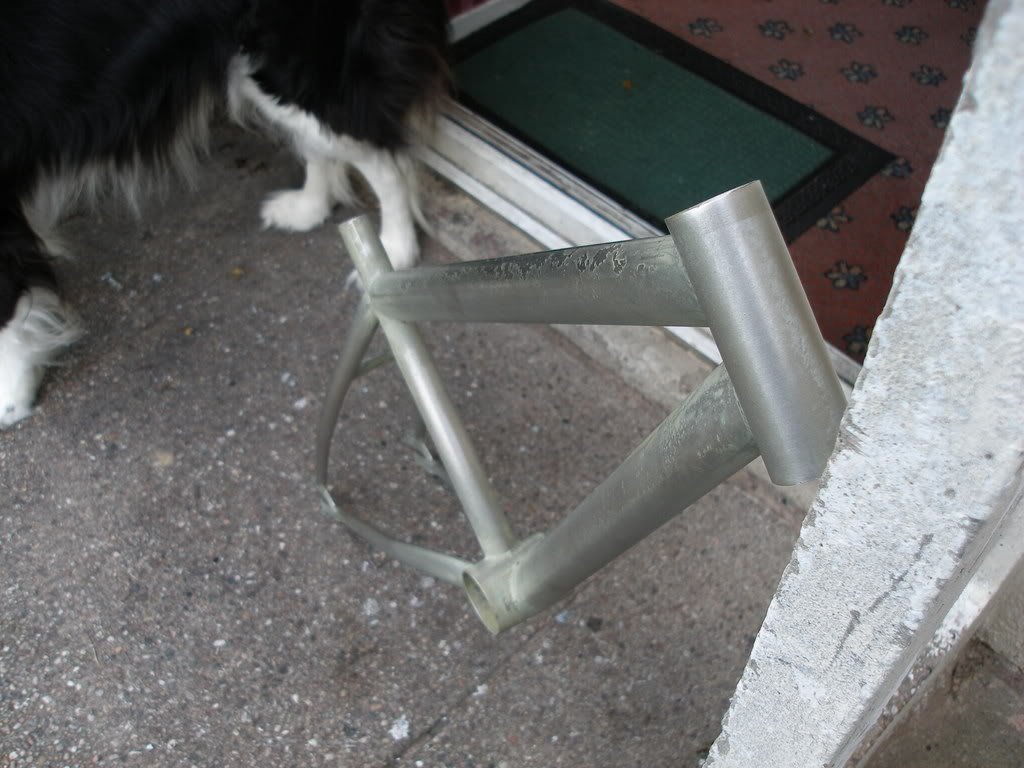

SAND PAPER TIME.........

ENOUGH FOR 1 DAY :LolLolLolLol:
