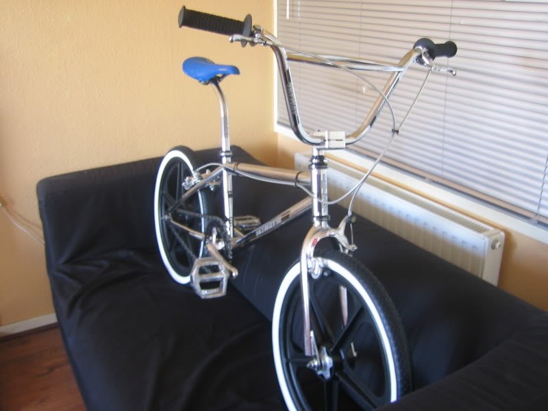

BMXBEN
Re: Tange 125 lp headset dont fit my skyway
« Reply #14 on: July 29, 2007, 04:30 PM »
BMXBEN
« Reply #15 on: July 29, 2007, 04:34 PM »
I know i know the seat dont match the forks are wrong (im picking some forks up at mk) & my 1/2 inch skyway pedals dont fit nor do i have a spindle & bb for my flight 400,s not to mention that the chain ring is not nos but im afraid im fast running out of time :'(

BMXBEN
Re: Tange 125 lp headset dont fit my skyway(yes it does see pics)
« Reply #17 on: July 29, 2007, 04:50 PM »
Ive notice a few bikes appearing with non stock decals & designs & wanted to build a skyway using just black & silver/chrome parts. but then the blue & red decals ruined the color scheme so i got Del off here to do me some custom decals & the result is what you see. I like it do you ? im bringing it to MK just to have a ride around im not gonna race it or show it as its not finished. Firebird also said he can make me a matching padset but time & money are not on my side at the mo bit gutted but hey i will finish it maybe not in time for mk but i will  :daumenhoch:

Where's your chrome shim on the headset. You haven't put that on and it needs to be there.  :daumenhoch:
