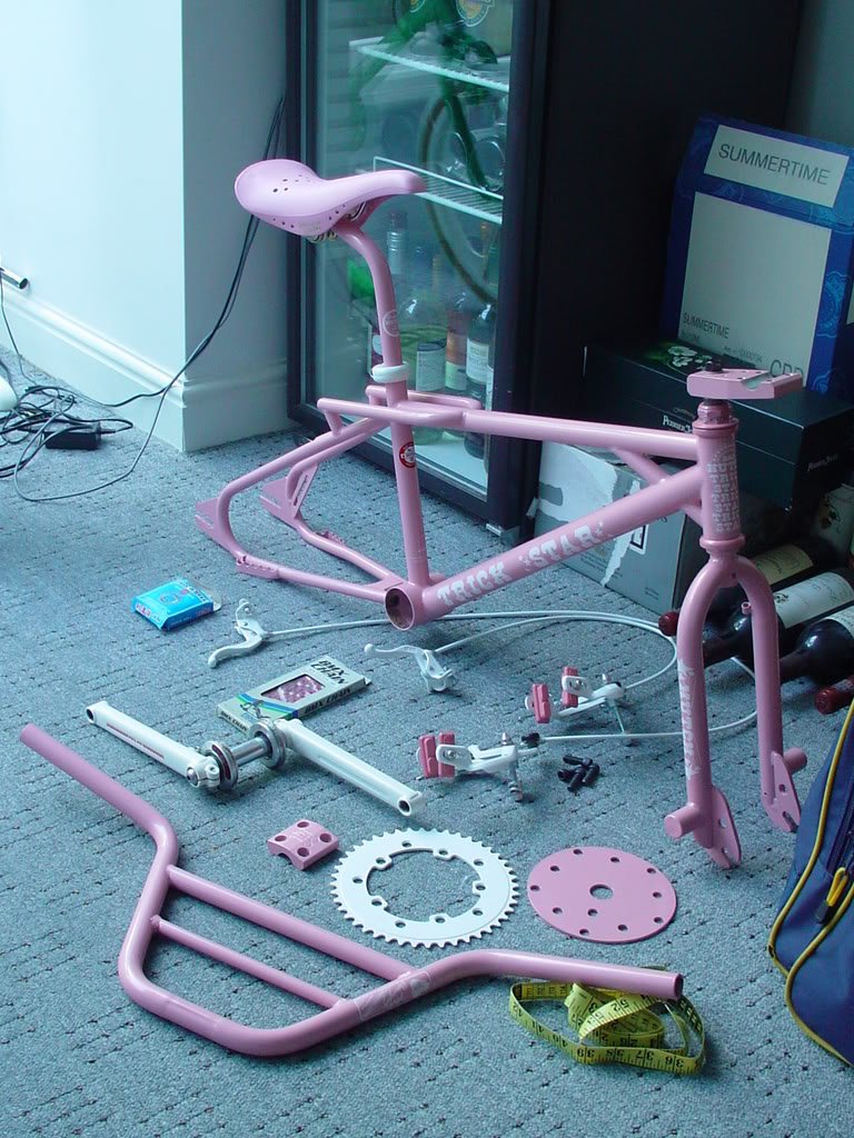

Well I've ordered a few off Ebay so hopefully the UNC ones will fit in fine. This is what its going on, nearly there:
