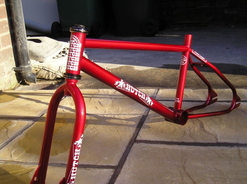

I'm after the paint code for that lovely candy red I've seen on various Hutch and SE Racing builds  :smitten:
Can anyone help please  ;)
Steve

Maskybeat did mine  ;)
Old School BMX only
Cash is King

That's exactly what I'm after Craig ... the Torker looks stunning in that colour  :daumenhoch:
Just need the get the paint code now  :)
Steve

« Reply #4 on: December 01, 2007, 11:35 AM »
Old School BMX only
Cash is King

That looks awesome Craig  :4_17_5:
there is some guy selling the powder on usbay, think thats where mine from on my hutch
Thanks Pete ... I'm getting a F+F painted in 2K so I just need the paint code for now  :daumenhoch:
Steve

I believe candy is a red clear-coat over silver/polished. Ask Mr. Radman he did that Trickstar I had and it was beautiful.

You're right Dave ... I'm pretty sure the candy colours use a silver base  :daumenhoch:
A decent metallic/mica paint match would do the job TBH ... I should've mentioned that in my 1st post really  :-[

if you go into any decent car paint shop and ask to look at the house of color or kandy paint catalouge you are looking for apple red, i have some paint left over, i will try and get to my sprayer to get the code for you, DO NOT powder it as it is not candy, candy red is like a metalic paint, you cant get the correct finish with powder, i can coat a frame set for £75 plus postage, lmk if you want me to do it

Kandy paint doesn't have an official code!
house oof kolor only produce 20 kandy colours each has a name, not a code.
i posted this in an old thread if any of it helps. (at the bottom)

candy paint does normaly contain a pearl effect to it, it either glimers gold or purple under strong light.
for me i went for transparent red on a super chrome base coat from caswell plating as i don't want the pearl effect,
i think they can supply for spraying as well.
