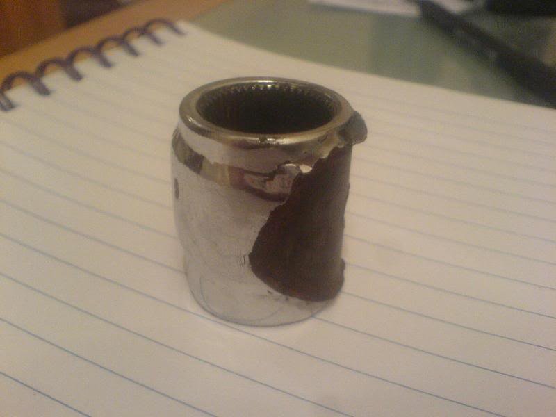

mmm, take a look at this crank arm, now i know billy pounds everything on his bike :crazy2: :uglystupid2:
but was surprised how fast this tore apart, about two weeks ago we noticed a stress crack on the welding,
really thought it was my powder that split :-[  anyway on friday at corby he pulls an air out of the big quarter pipe
and on landing it ripped apart >:(  could have been a real bad injury from this but luckily he rode out of it ;)
spoke to profile and they said,  return it and they will send me a new one :daumenhoch:
i'll let you know how we get on

I was thinking that when I first saw the pics, they'll probably use the excuse that you've powder coated them.......wouldn't surprise me!

They look rusty as fook inside???
Next time you spot a crack on Billiy's bike dan swap it out straight away eh  ;)

they were worse than rusty

yep, already thought of that excuse so tomorrow i'm gonna strip the paint of so it's back to chrome, and yes i thought they where
rusty inside >:(

As for the Profiles, they are designed for racing so they are a bit thinner and a bit lighter.  Get something like a Primo Power/Hollowbite, We The People Royal or Oddy 41 Thermal (not Wombolts).

seen a fair few riders snap profiles over the years but then again after some of the abuse riders have given them many other cranks would have given up the ghost years before. rider i know called coady has been thru a few pairs (arms twisting) and fair do's they have sent him new ones, but like everything , if they can give an excuse not to honour the warranty for what they think is not their fault i'm sure they will. those new shadow conspiracy cranks are pretty crap- i've seen them snap clean off at the pedal boss on a young rider who isn't a harsh rider. another mate got some new odyssey cranks which were made wrong. the arm was 1 degree out so a mate had to take to his works and have em realigned. with everyone shaving weight off the bikes i think a little extra weight for strength / injury sacrifice is one worth taking.
