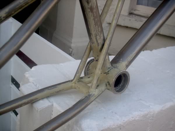

ive just got the titan mini frame through from steve first thing i need to sort out is this weird bb size.
the hole on the frame is 38mm with cups that would take bearings 34mm.
this is a new one on me so can anyone shed any light on it and point me in the right direction :daumenhoch:

the actual hole on this frame is 38mm,the outside diameter of the bearing is 34mm
these were very special and very expensive frames,made of titanium and arc welded under water :shocked:
dont think titanium was used on any other bmx bikes then.
even the headset's are different bloody 7/8 on these

Do you have the cups still? If you do, what is the OD of the cup?
winnit93
Re: BOTTOM BRACKET HELP IT'S NOT EURO OR AMERICAN!
« Reply #11 on: January 30, 2008, 02:22 PM »
yes mate i have the cups o/a size is 39mm on the back of the cup

this is a 1985 model but even this looks smaller than the one i have
this is mine

I saw that one as well and assumed the other was the same size - but as you've shown, it's not.
I definately have no clue and Sheldon Brown's website can't help either  :-\
