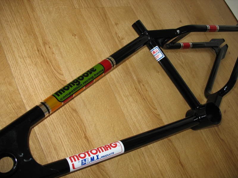

i was given this motomag frame a while ago but was in real bad shape but i couldn't bring my self to throw it away so i decided to repair it,heres a few pics of how its going
first of all i welded up crack in top tube
then fabricated a new gusset as the old one had been badly welded before
then i removed old gusset and remainder of seat tube
this is the new seat tube and gusset mocked up to check fit all thats left to do is clean up seat tube and get it tig welded
« Last Edit: May 27, 2008, 09:48 AM by sawzall »

rich,the weld has been ground down then sanded down with a da sander  ;)

heres a few up dated pics of the motomag frame,i have had it tig welded,and i have repaired the rear drop outs as they were badly crushed and out of shape just got to get it prepped and painted when i get the time :(

HERES A FEW PICS OF THE MOTOMAG FRAME FINISHED,I FINALLY GOT AROUND TO PAINTING IT LAST WEEK AND STICKERED IT UP LAST NIGHT :)

Is the top tube decal on wrong way about  ??? thought it was the red part at the front and orange towards the back :-\
