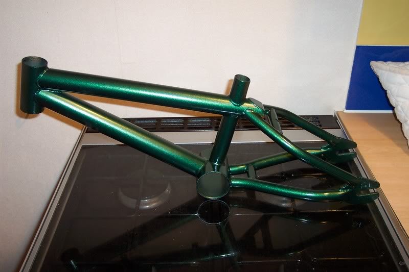

hers me boys bike i did in nissan green with a hint of gold fleck
i just scotch brited the orange frame did 2 coats of green
and two clear coats .paint has lasted pretty well considering what he's put it thru
