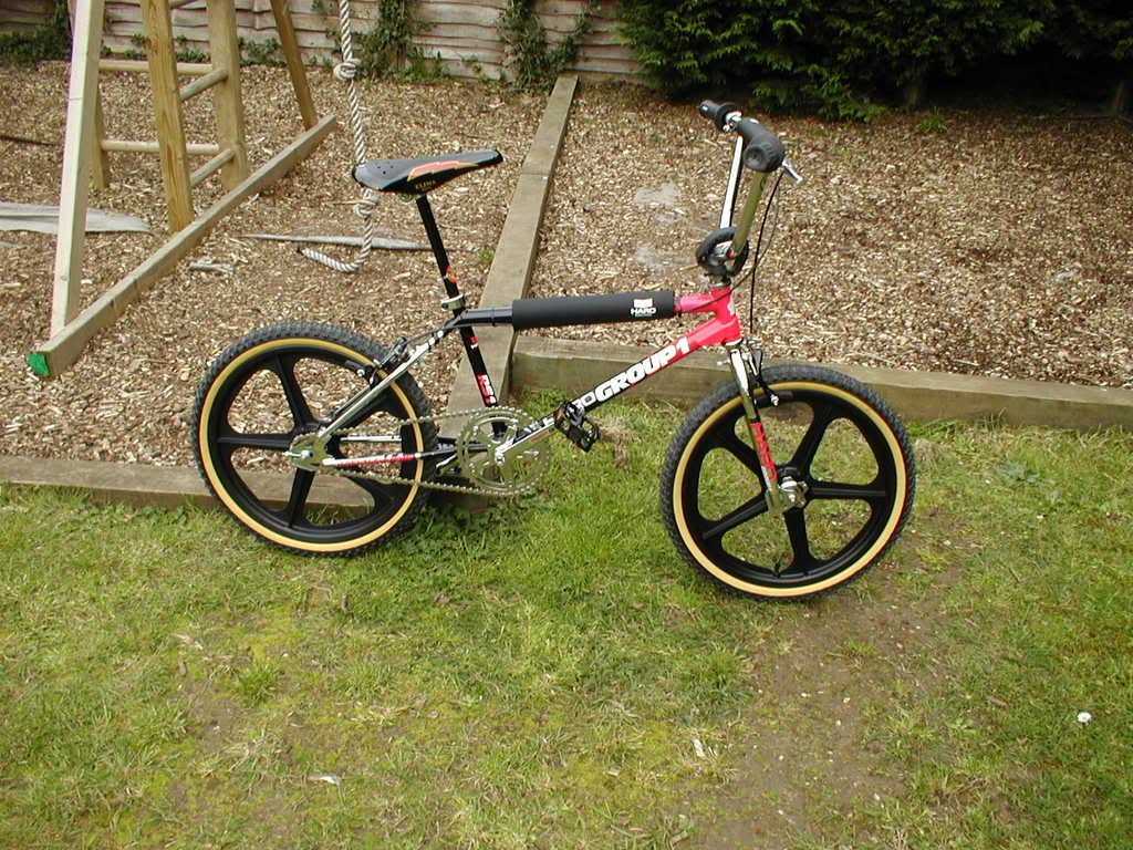

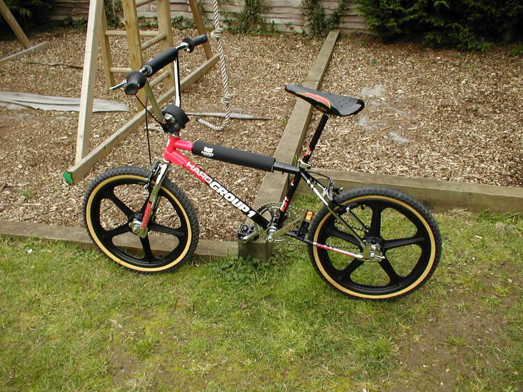

fitted ....
Re: skyway back to black brothers and sisters! UPDATED ,FITTED
« Reply #24 on: April 26, 2008, 05:22 PM »
Looking good  :daumenhoch:
I'd pull the bars back a touch though to make the steering a bit slower; you might find the front end twtchy on dirt  :daumenhoch:.
