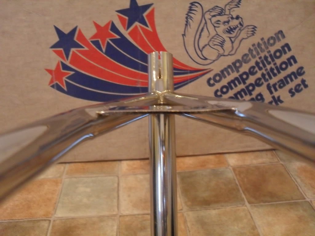

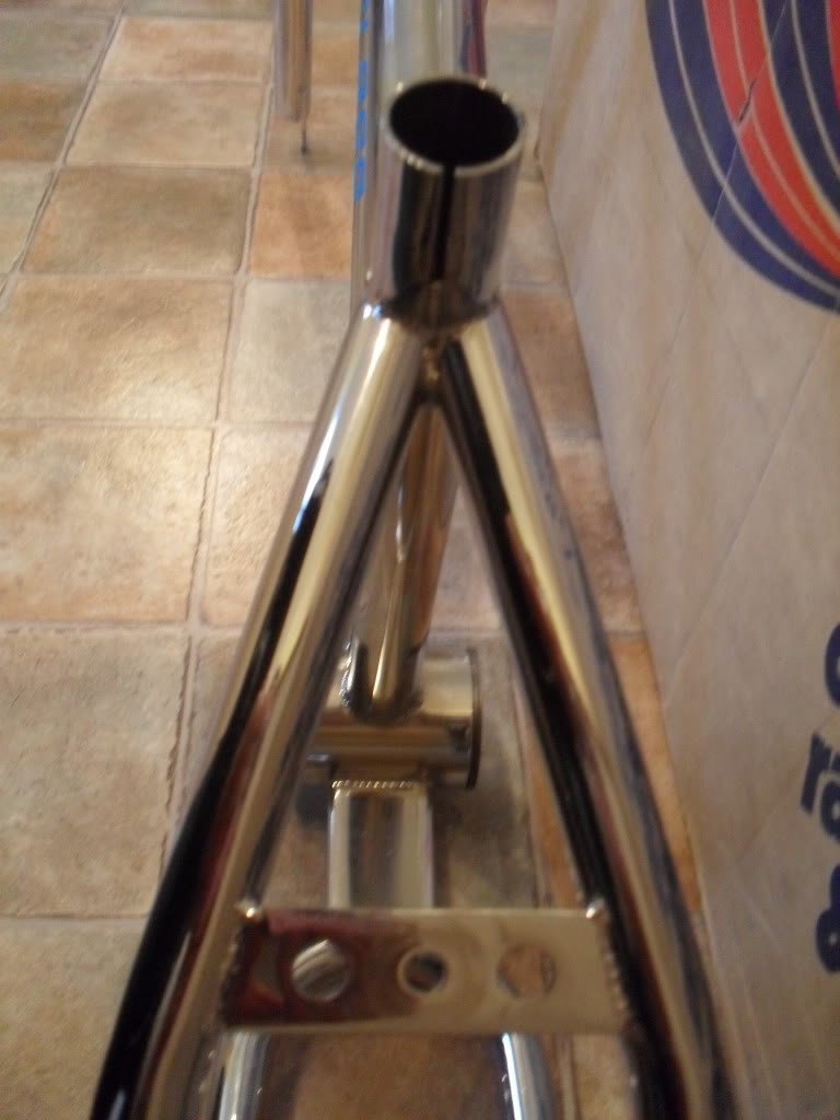

Got this pro class f&f from HRD Racing last week, gave it a good clean & its come up nice. (can someone confirm it is a genuine pro class plz)
Only small problem with it is, the brake bridge is slightly bent inwards :idiot2:
not sure whether anything can be done about that? (any advice?)
Also it came with no stickers on, but when you catch the chrome right in the light you can see it has had 'OP Racing' stickers on both sides of the down tube, anyone know what the heck OP Racing is? or anything about them?
The other thing i want advice on is the serial number, its: B3001846  am i right in assuming its a correct pro class serial & its Feb 1983?
Any help always appreciated  :daumenhoch:

Offline jimmyp
  • Posts: 1550
Re: pro class help
« Reply #5 on: April 27, 2008, 04:44 PM »
Need to take those bottom bracket cups off and have a look at the frame thickness, this is another way to tell  :daumenhoch:
Get a pic posted up and ill tell ya ;)
djgivvinup
Re: pro class help *updated*
« Reply #6 on: April 28, 2008, 09:44 PM »
Cheers for all the replies & stuff   ;)
Heres some pics of the bottom bracket for ya Mr jimmyp, let me know the verdict  :daumenhoch:
Thanks again..

Ok m8 there should be a hole inside the bottom bracket where the seat tube is, if there isn't its a usa supergoose, if there is its a pro class.  :daumenhoch:
« Reply #11 on: April 29, 2008, 09:16 AM »
USA SUPERGOOSE 83
PRO CLASS 83
PIC OF SUPER, CALI, PRO CLASS THICKNESS
As you can see in pic 3 the pro class tubes are really thin.
Judging by the thickness of your frame m8 i think its a 83 usa super, sorry :(
Jimmy
I think your pics would be more helpful without the bearing cups in them and the bottom pic of all three BB's, I take it the pro Class is at the top, then moving clockwise the Supergoose and then the Californian; is that right?
regards
Marty  :)

Right...i had a look inside the bb area on the frame & there is only 1 hole coming from the down tube, theres no hole frrom the seat tube  :-[
Does this definetly mean its not a pro class frame?
Also what thickness should the frame be around the bb area?
The rear chainstays are chunky as hell, were the us supergoose frames that chunky?
I did get the original mongoose pro class box that the frames were packaged in bitd with the bike when i bought it. But i suppose that could've been for another f&f that he had??

djgivvinup
« Reply #17 on: April 29, 2008, 11:52 AM »
Thanks again for all the replies, much appreciated  :daumenhoch:
heres some pics of the dropouts for ya Atari  :daumenhoch:
I can squeeze the rear dropouts in with 2 fingers no problem..but looking at yours the dropouts do look a bit thinner  :-\
I'm off to weigh it very shortly, i'll let you know the outcome.

Offline AtariAger
  • Posts: 269
« Reply #21 on: April 29, 2008, 01:32 PM »
Definitely a Pro Class you got there!  Nice job...pics tell no lies!   :daumenhoch:
~Tom
