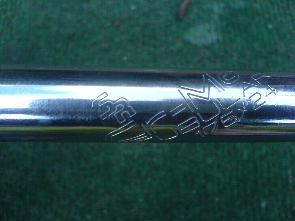

A mini Pro Neck stem this time and I'm guessing it's quite a rare piece now ... nice too  :coolsmiley:
Here it is when I got it from a fellow Radster ... thanks John  ;)

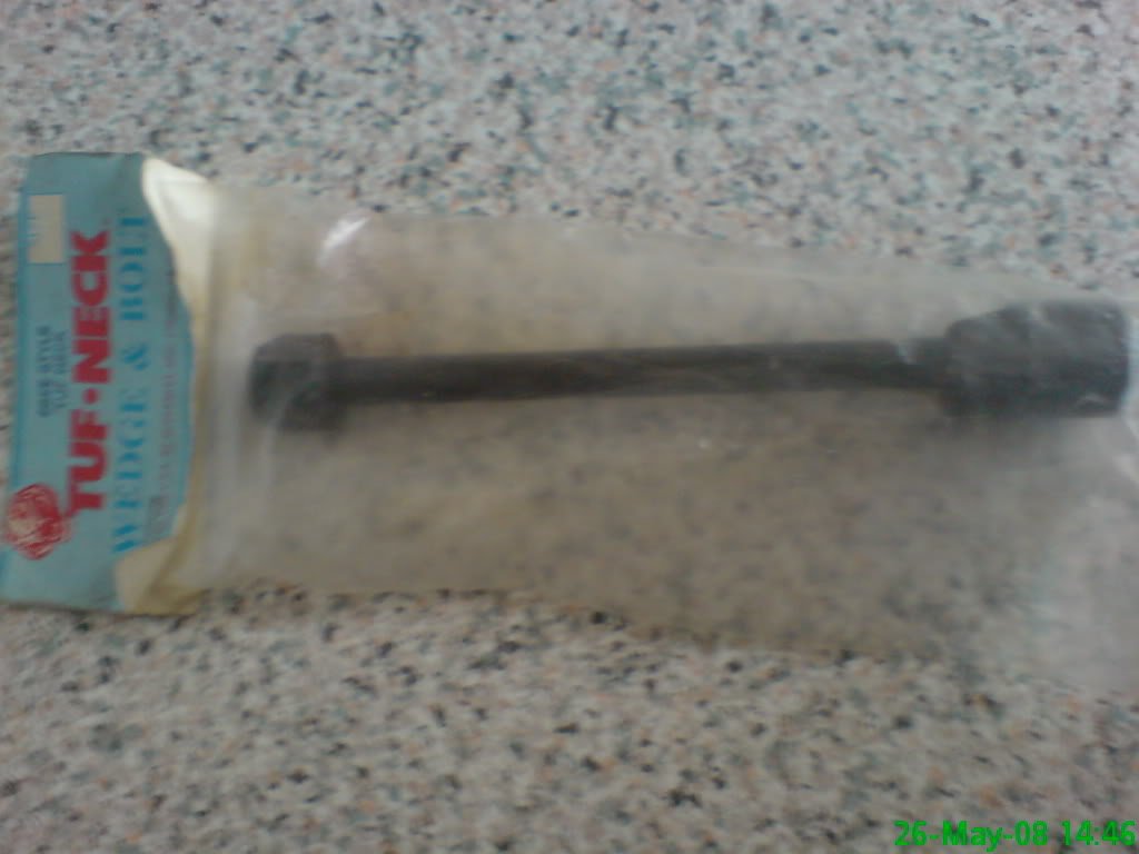

I decided to go for the brushed finish this time and recoated the main bolt and quill. The quill bolt and wedge were also wrong so I replaced those along with all the other hardware too
Not a major resto job but I get a real buzz out of bringing this old school stuff back to life ... hope you like  :daumenhoch:

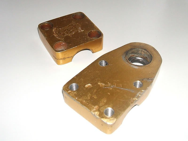

do you reckon theres any hope for  this little rascal ?
how could i get the tasty looking hammer marks out(NOTE not done by me  :daumenhoch: )
ive got a new bolt for it so that dont matter?

do you reckon theres any hope for  this little rascal ? how could i get the tasty looking hammer marks out
Nick ... that stems worth saving but you'll have to get the dents filled with alloy weld first. Don't try to polish them out or you'll end up losing the logo
Here's another stem I did a while back which was badly dented  :shocked:
