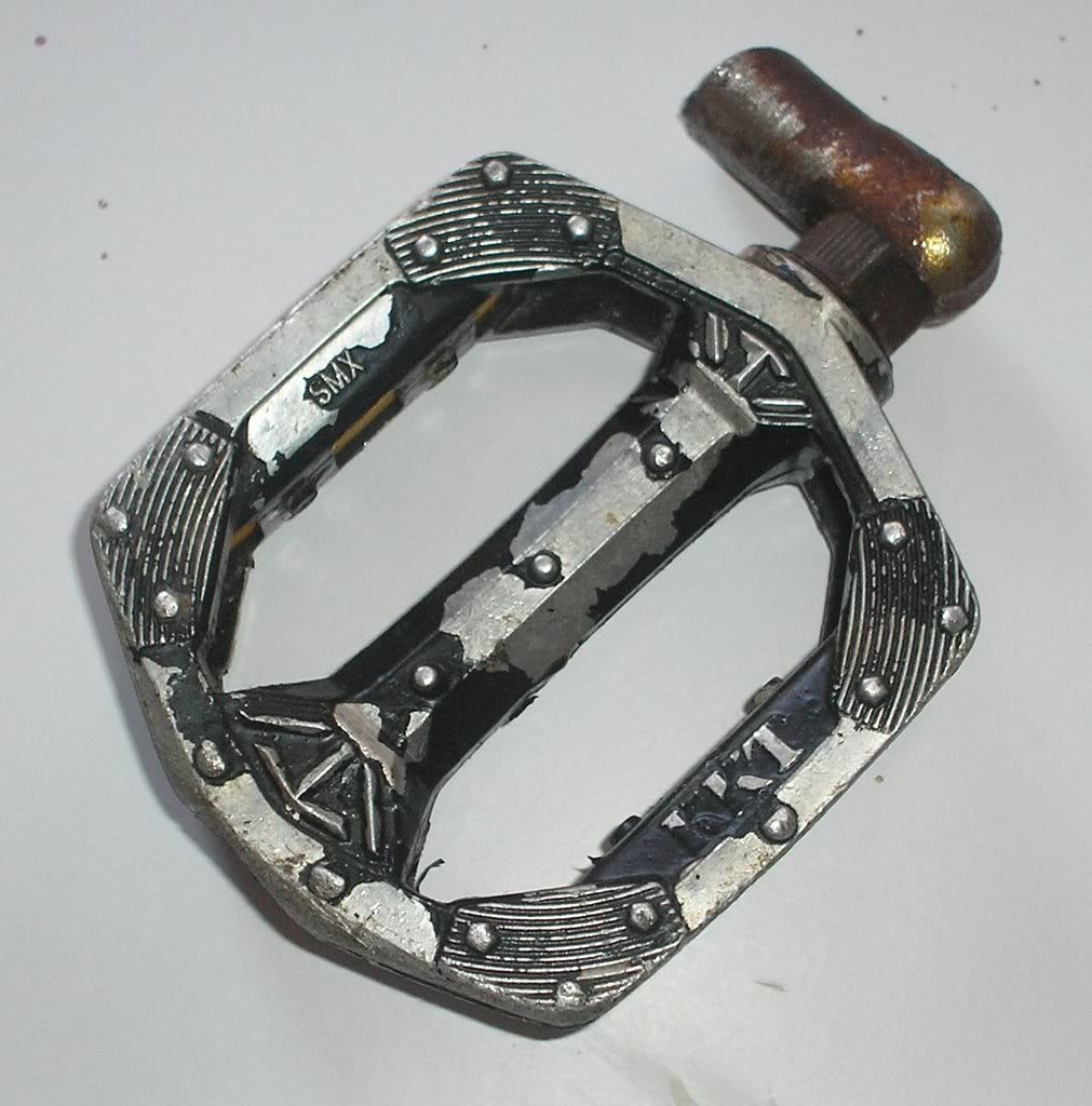

will cutting through the thread with a hacksaw work or will it f up the pedal, if so is there any other way,
Cheers
Fraz

me i would weld the rest of the arm back on for leverage and the heat from the welder should expand the arm and help the pedal to release
needs lots of wd40 before to get the rust moving.

Cut through the crank diagonally across the area where the pedal axle screws in, cut round as much as poss (halfway will do) but be careful not to cut through....  Stick an old screwdriver or better still a metal chisel into the hacksaw slot and whack with a hammer.
With any luck the crank will split apart and you can release your pedal  :)

Mig welder, run a big bead of weld round the pedal boss in the crank arm, the heat will make it very easy to take it all apart, although, I am not sure why you are bothering?
I would just bin that lot!

If these pedals are hard to get hold of why not find out if the spindles are the same as kkt pedals that are available if so buy them and take this off the spindle and put it on a new one. Just throw the spindle stuck on what's left of the crank away.
