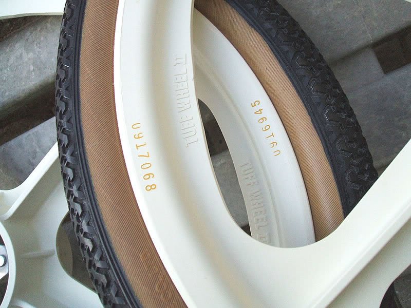

These coaster Tuffs are practically NOS and were quite grubby when I got them but they scrubbed up quickly without the need to soak in bleach ... I just used a standard cream cleanser and a 'greeny' cloth which worked a treat
Original serial numbers still present ... how cool is that  :shocked:
