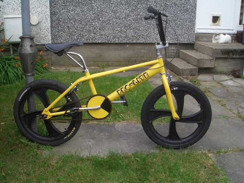

Not having looked at BMX for 20 years, a recent nostalgic thread on another forum prompted me to buy a cheap fixer-upper to mess around with. Problem is, my vast teen knowledge is no longer relevant and I'm a n00b again.
Got this old heap for a fiver:
Now I've no idea if Pro-Lite are actually any good these days for starters. Any coments on that?
Anyone ID the frame model? That'd be handy for the spec.
In particular it needs new head bearings and gyro - are these standard size across bikes now or do I need to be careful?
I had a brief ride (hairy with no brakes) and it seems a bit heavy. Feels longer than I remember too - have BMXs grown in 20 years?

Bought a 1" headset. Seems too loose. I'm right in thinking that the retaining cups for the bearings that fit into the frame should be a tight fit, aren't I? The current set has play in the frame. It pulls in when I tighten everything up but that doesn't seem right to me.
I'm told the frame is the same as a '93 Haro Master and comparing geometry by overlaying photos seems spot on. Can anyone confirm a 1 1/8" headset should be what I need? Don't want to buy that to find it matches the frame but the nuts don't fit the thread on the fork. I'm not sure what this magic 1 1/8" dimension is - across thread, across frame ID, or some other point.

Cups aren't just a little loose, they rattle around, so I'm now sure they're the wrong size. Going to visit the other bike shops tomorrow, with luck I'll find a cheap 1 1/8" to try. I'll measure up first and take the forks with me for comparison. There are BMX kids in the city, so someone must be selling them parts.

I'm pretty sure that's a late 90's Haro Zippo, a lot of the parts on it are Haro, chainring, forks, stem etc, is it chrome underneath the paint as all those old prolite frames were? Either way both those frames used a 1" headtube.

Success. Despite none of the 3 bike shops in the city centre being able to help, I found a headset in Halfords of all places. The old one I tried was old school 30mm OD on the cups, the new one is the correct 32.7mm OD. One step closer to being back on the street :D

Back in business :D
Still needs a few tweaks (like a real logo instead of a photoshopped one), but its all in one piece again.

Following a proper test ride, I realised there was more play in the head than tightening the headset would solve. I've pinned this down to a couple of things.
Firstly, the bottom race on the fork wasn't a tight fit. Easily resolved with a coke can shim.
My bigger problem is an ovalised headtube. Tried shimming it and its helped, but I'm not really happy with the result - there's still noticeable play.
As its a bargain bike and a daily rider, I just want a cheap and easy fix, its not really worth paying for a new tube, welding and skimming or the like - I'd be getting to the point where I may as well buy a new frame as I'd need to pay someone else to do it.
I'm curious if anyone has had any luck with metal fillers instead? I'm thinking that properly clamped up and with the bearing faces of the cups protected by putty or similar, it should be possible to flow liquid filler into the gap area for a really tight fit.
Is this a stupid idea that's already been proven disastrous or is it worth pursuing further?
