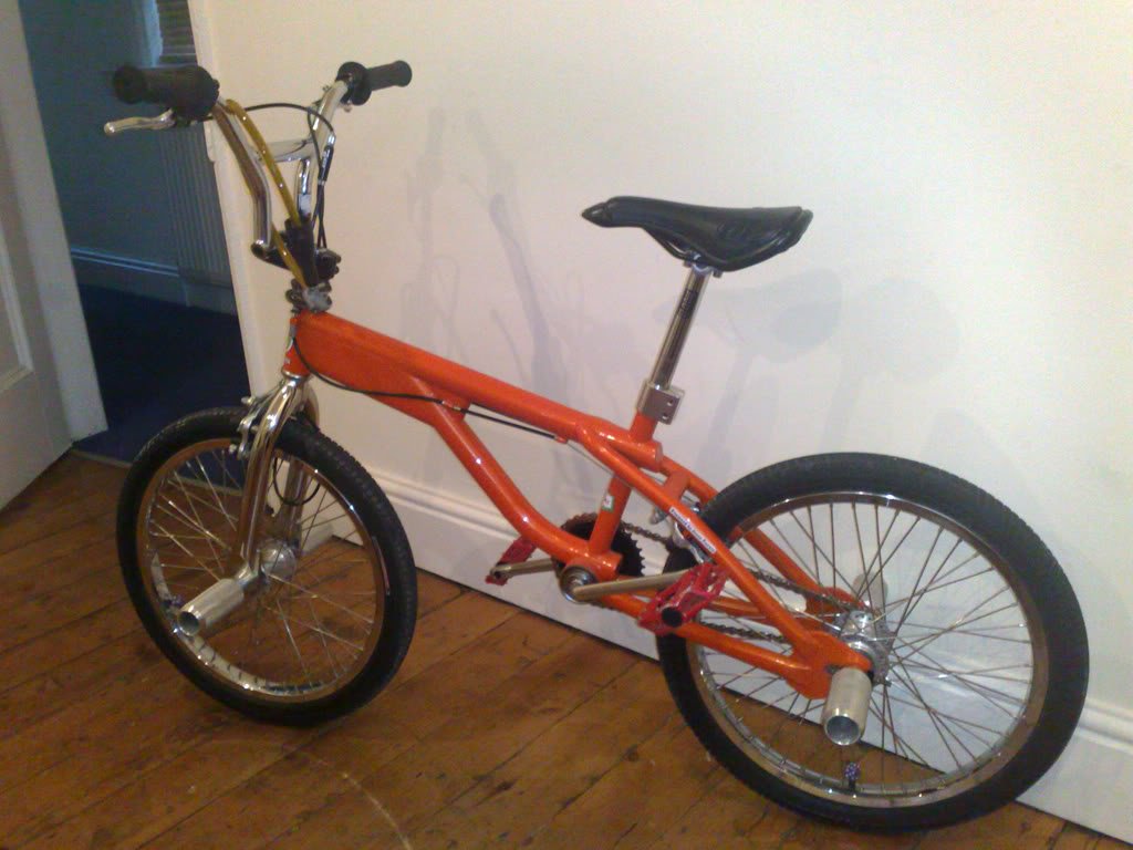

ok so i've bought this, always been into my flatland, getting on a bit now (36) but thought sod it. Im on the lookout for a DP Freestyler to work on but i wanted a bike that was ready to go and i could get some seat time whilst i work on a bit of an old school project.
So yes .. KHE Premium Lagger.
It's a bit heavy ! ... and the crank is slipping like a biatch .. needs a damn good service

but why's the crank slipping? does the chain ring not lock onto the crank spins or is the free wheel busted?
and why didn't you take the lock off for the pics?  :daumenhoch:
great bike though, niice find. what was the damage if you don't mind me asking?

Now bear in mind its been a while since i've ridden BMX. I had a cruiser that i rode for 2 years and didn't do anything to it. So ..the crank problem .. There's about a quarter of a turns movement before it kicks in. Crank is locked into the chain ring. So would that mean there was a problem with the free wheel ? .. speaking of which .. it doesn't freewheel, ie i have to pedal backwards when im going backwards.
Help ... im like really confused.

it does freewheel dude. it's normal to pedal backwards when you roll backwards unless you have a freecoaster.
sounds to me like the freewheel is shagged. but i'm not expert.
I reckon that's a steal at £130 but then i've never seen one for sale so i have no idea of the market value.
but a quick look at the parts and i reckon its way over £130 worth.
I would have paid that for sure.

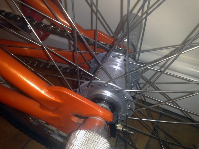

Can't tell what make the rear hub is, no markings on there .. took a piccy. Wheels are Araya Super 7X's ..
So if it is a shagged freewheel .. what do i need to do ?? .. replace entire wheel ?

we need to see the cog on the other side of the hub ;) if it's a freewheel then yes you can just get it romoved (unscrewed) & bang a similar one on in it's place. If it's a freecoaster (it does look a bit like one due to the diameter of the hub body) then it's a case of stripping it down to find out what's worn. You say you have to crank quite far to get it to 'engage' which would suggest it's a coaster & the most common failure in a freecoaster hub are the springs for the clutch resistance which may be hard to find :(
If you plan on riding flat then you should have a freecoaster hub anyway dude :daumenhoch:

and Ian rides a freecoaster in the park.  :daumenhoch:
that sure is a chunky hub so it probably is a freecoaster.
even with a new hub and rebuilt wheel i reckon that bike is a steal.   :daumenhoch:

ahh ... sorry guys ...
Here's t'other side. Alansbmx isn't too far from me  .. they could rebuild it right ??

I'm thinking it may be a variant of one of these?:
There's nfo about them here: http://www.free-coaster.com/html/ultimate_hardware.html
Uses the same internals as the reloader (which I run) & you can get some spares for those hubs from Pat @ Flatlandfuel if you can't get them over here:
http://www.flatlandfuel.com/index.asp?PageAction=VIEWCATS&Category=14&Page=3
Do you feel man enough to strip it out dude :LolLolLolLol: I'll know for sure then :daumenhoch:
PM me if you need some help...
