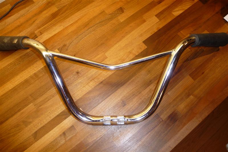

Right then here's a pic of the bars cos i'm not an ammaco expert (if it ain't a goose i'm fooked  ;D).
They came off an ammaco but i'll leave it to you guys to ID them :

Nice bars, deffo ammaco mate! Simon buy them now  ;D
As for the redline stem, if its a proper one about £60 in a good condition, needs resto about £45 and a copy about £30. You can't really tell the difference with the copy at all mate to be honest, all look the same but some of the redlines are stamped and painted "REDLINE" at the front, some are not (like mine)

Si hi mate. All of them are not ammaco bars.
1st one - WinV bars. Alloy. All ammaco's were steel.
2nd one - looks cheap and nasty, v is too low down
3rd one - Wrong style and alloy also, incorrect for ammacos.
If you want blue, buy the correct bars, get them blasted and powdercoated, won't cost you more than £20.
