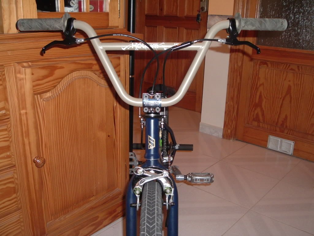

I know there is a few of us here who run front brakes on our bikes so this might be of interest to you. Running a front u brake on your bike is great except IMO the fact that your cable passes on the outside of your forks due to the adjuster set up you get with your brake and i think it looks untidy, so when i read a thread on here about someone using a Vbrake cable noodle instead of the usual adjuster I thought what a great and simple idea.
So I went to the local bike shop and got a 90ยบ Vbrake noodle and headed home to give it a try.
5 mins later (After cutting noodle to length) I was finished and very happy with the result, Not only has it improved the look buy tidying up the cable route but it has taken the spoungyness out of my front brake to.  :daumenhoch:
BEFORE..........
AFTER.........

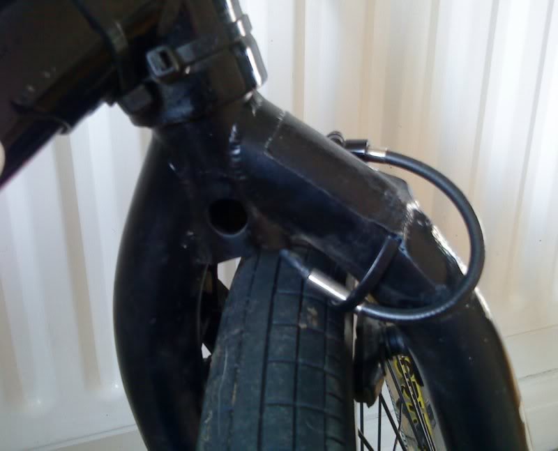

I've got the same mod on mine.  In fact I've gone nodle mad and put them on the back too. This isn't the best pic but you can see what I have done.
The noodle mod does make a difference. It takes out the spongyness that you get when a cable is looped and allows it to be routed more neatly.  It is especially good because you can remove the plastic liner from the noodle, take the noodle apart, and dremmel off an inch or so.  This allows the (now) excess inch of plastic liner to be inserted in to the adjuster barrel, lining the whole lot.  That takes out a surprising amount of friction.

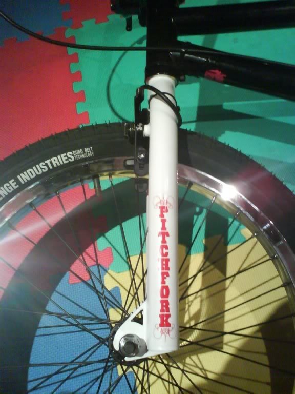

Joe, here are some pics of my front brake and cable.
I have actually got 2 types of outer cable. The upper part of the cable is a liner cable. From the lever down to just below the forks. Then Ive got a short length of normal coiled cable for the bend. I have got a outer cable joining ferrel that also doubles as a good place for a cable tie cos it wont crush it.
Hope the pics help. Feel free to comment on my hand painted fork decals
