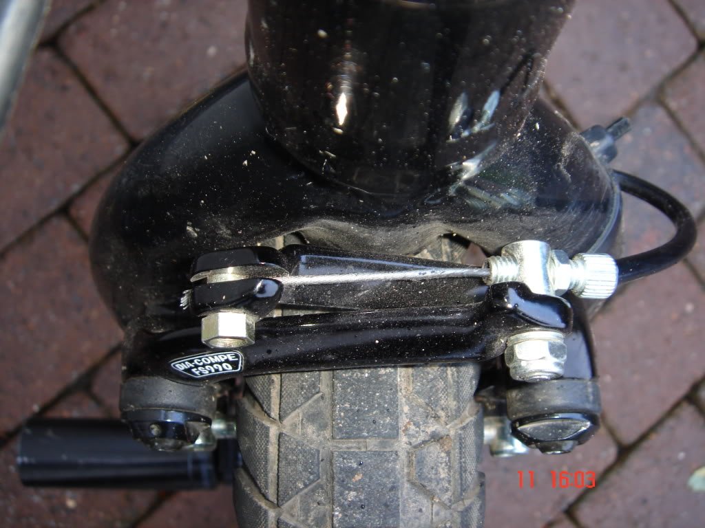

Joe, here are some pics of my front brake and cable. It was on another thread that you asked for them but it seems OK on here.
I have actually got 2 types of outer cable. The upper part of the cable is a liner cable. From the lever down to just below the forks. Then Ive got a short length of normal coiled cable for the bend. I have got a outer cable joining ferrel that also doubles as a good place for a cable tie cos it wont crush it.
Hope the pics help. Feel free to comment on my hand painted fork decals

Greg,  I  understand now buddy.  I can see where you've got shitloads of flex and movement.  We need to simplify all that   ;)
So,  get rid of the cable hanger thingy, get rid of the straddle cable.   What you're gonna do is copy a front brake setup, but on the back on your bike. You might need a noodle just to help with the loop thats gonna be right where your heel is gonna catch it...
Your cable is going to run straight into the side of the AD, just like in Alex's photo.
Have a trawl through here and you'll find lots of pics of peoples front brake setups   ;)
I'm going out now, but see if you can get your head around it, and I'll look in later on   :)

nice one Alex, my loop isn't quite as short as your's but I'll be fitting forks with brake mounts soon, so I can tweek it then.
but you've helped no end there, i was under the impression i needed a big loop going down and up, not in from the side but your's looks good and makes sense.
Re: fitting an AD brake plate
« Reply #13 on: November 11, 2008, 01:05 PM »
Yep, nice and short and neat. Like Ian has it there too.
Make sure you dont strap it too much to the fork leg cos its gotta move when you pull the lever.

You don't need the adjuster. Don't worry about it.  Greg, you're gonna just jam the outer cable straight into one side of your AD, and then put a nipple clamp on t'other end and drop that into the other arm.  Make that fairly snug, then you can simply make your fine adjustment at the lever.
You may well feel that you're putting it together the wrong way round,  have a look at Steve's photo.  You're gonna jam the outer cable into the left hand arm (as you look at the photo), then secure with a clamp on the other arm.
Assuming your AD looks how I think it looks......
