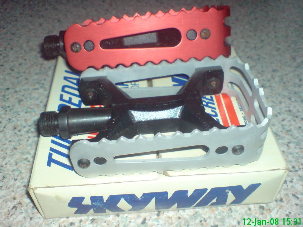

Offline Nicfred
  • Posts: 469
Re: How to strip anodizing ?
« Reply #5 on: November 11, 2008, 01:16 PM »
i did these,they were red and now there not and they look  :smitten:  :smitten:  :smitten: then chuffin sold em  :'(  :'( (and as usual wish i hadn't)  :'( sold them that is not oven prided them  :'(  :uglystupid2:
