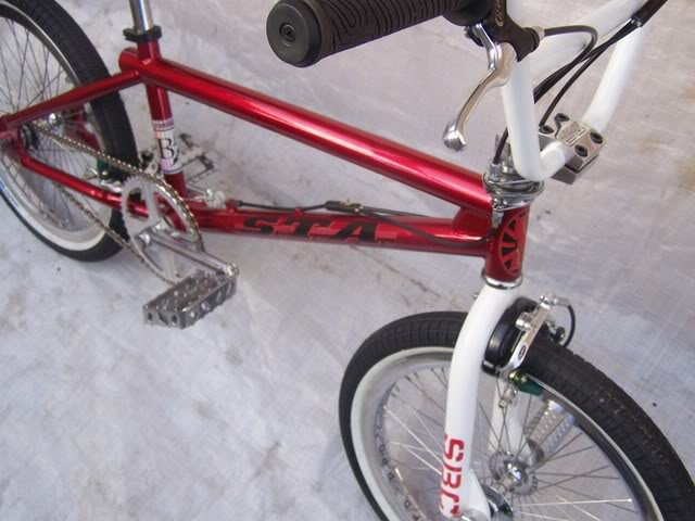

this is what i mean like on my sta
Re: wheels for a mid build
« Reply #2 on: December 24, 2008, 02:34 PM »
with regular hub
with 48 h unbraked hub with coaster arm

dam them bikes are nice dan
cant see the arm on the 2nd pic though its not monted to the frame is it?

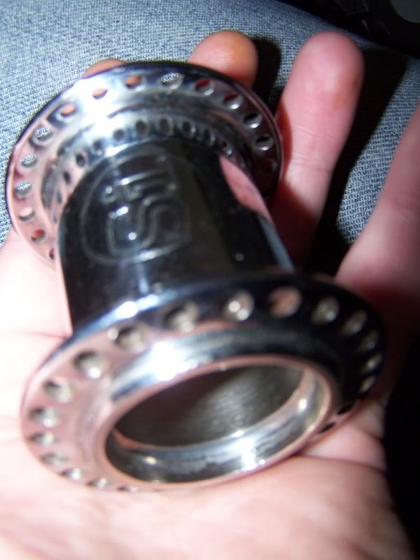

you do remove the pads and insert spacers the unbrake that is.
you could get them at custom riders years ago
they are a regular oldschool coaster  all you do is knock of the end caps that have the 3 holes in
make 2 new rings drill 48 holes and weld is best back on.
the radials are stronger in one direction for all the front end stuff but will suffer if you go mad.
i do like radials and built them on a few of mine.dont give up bert its all the fun dude.
yep its mounted on the slot bert.

mines a standard hub fairly rare got it of lazarou   :smitten:  and got a set of guts from a regular old coaster
and did the conversion myself  2 minuite job.

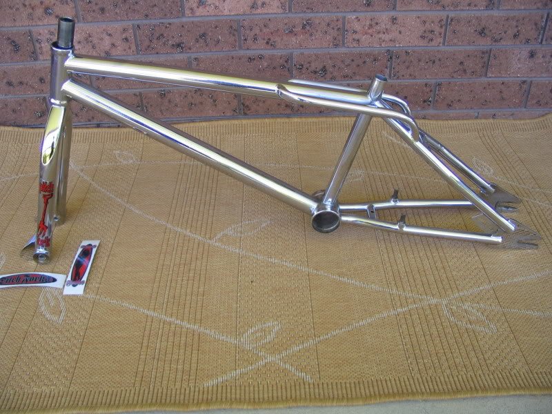

im scared to ride it to hardas its so rare..the only other one i know of has had a re-weld at the head tube i'll post some pics of it so you can see what it will look like built up and then you can give me your opinion on the bash guard idea....
bmxbert
« Reply #21 on: December 26, 2008, 12:45 PM »
this one belongs to a museum member its the only other one either of us can find
looks great built up and im so glad his had the correct decals so i know that i'll be getting the right ones repro
ive actually bought a dirt bike with them on to copy from it was missing the headtube decal but harris sorted that for me
cheers bud :daumenhoch:
