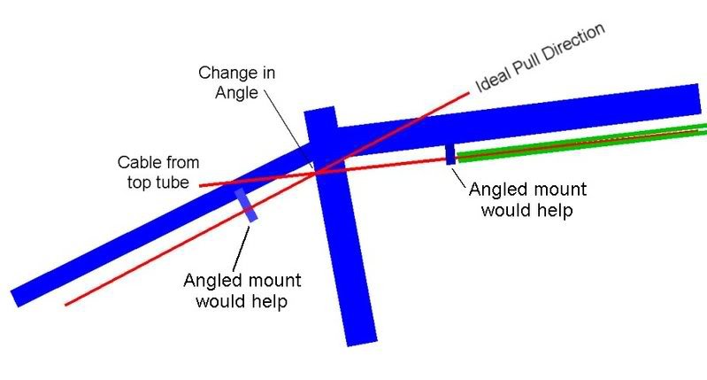

I'm no engineer, but I would have thought that having the kink/bend in the stronger brake arm is better than having the cable kinked.
The problem is that the cable is pulling at an angle from the brake mounts. It makes no difference if the cable or the arms are kinked, you are still pulling from above (or below) the mounts, rather than in line with them. The kinked arms spread (hide) the bend. Some of it is at the arm, some is at the arm/cable junction, and some is at the cable/cable stop junction. Staight arms only spread the bend between the two cable junctions, which makes it look more obvious. They are both EXACTLY the same: the cable is pulling at an angle from the brake mount.
Angled arms do stop the cable junctions from having all the bend, so the cables might last longer, but there is still power lost from the lever. Mounting the cable outer stop at an angle is a big help, and Angled brake mounts help loads too, but they do look very strange.
« Last Edit: March 10, 2009, 11:44 AM by S&MAlex »
Stella Dave
Re: Dia-Tech AD999 Chainstay version on seat stay?
« Reply #15 on: March 11, 2009, 04:31 PM »
Great diagram, this is wot was running through my head about the cables also. The cable at the london mod is gonna be rubbing on the adjuster the worst of all points. May try and think up some noodle mod for it.
