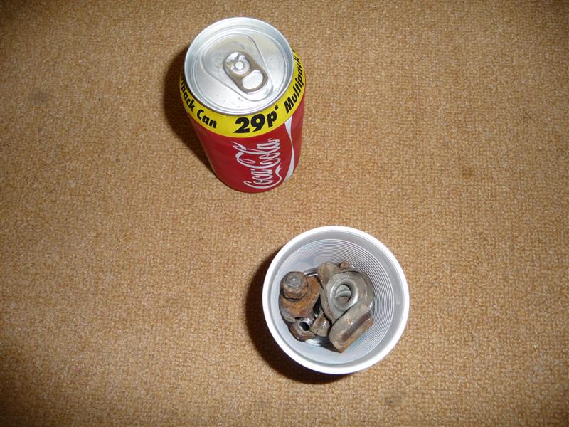

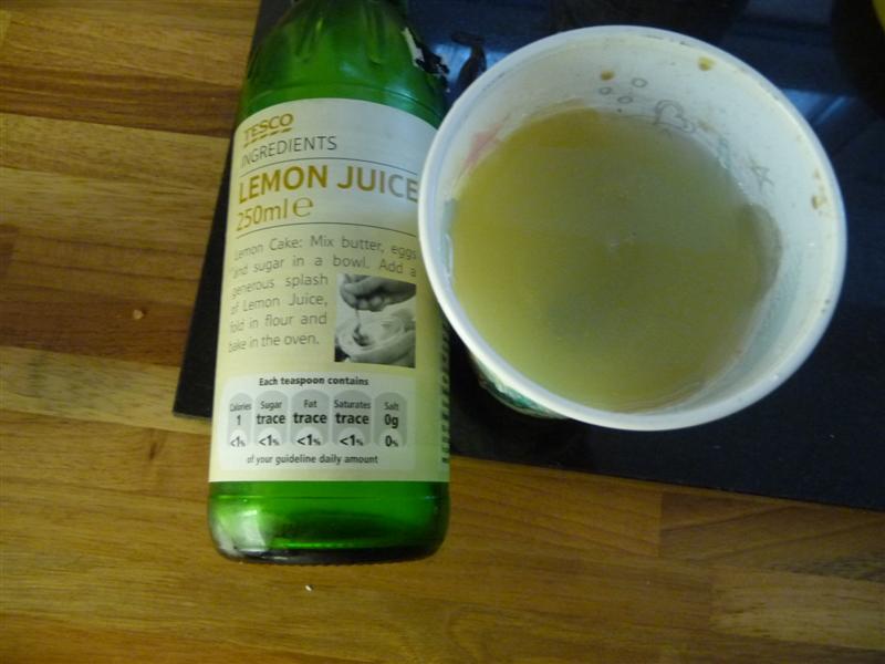

Had some seat guts in need of some TLC, so I set about removing the rust...........

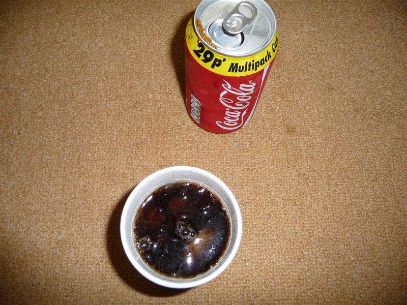

........started with a coke bath for them  :LolLolLolLol:
Chucked them in a cup with half a can of coke and left them for 24 hours (drank the other half of the coke  ;D )
Wasn't that thrilled with the results though  :(
..... decided more ation was needed  >:(
.....so next up was going to be a coating in HP sauce - yum !

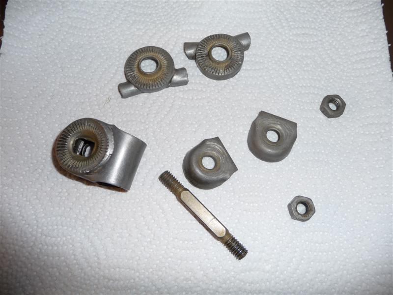

..........BUT....... I found a bottle of tesco's lemon juice in the fridge...hmmmmmmm
....I Had read about the powers of citric acid on rust before so decided to give it a go  :)
.......Much happier with the results this time  :daumenhoch:
......Finally gave everything a very quick rub down with some Autosol....
.....and bingo, lemon fresh shiney seat guts  8)   :LolLolLolLol:

How long did you leave it in the lemon juice, 24 hrs again ?????
Re: Rust removal - seat guts
« Reply #4 on: May 10, 2009, 06:07 PM »
Hi Andy - yes mate another 24 hours did the job  ;)
I don't know if the coke played any part in this process - maybe it broke things down a little for the lemon juice to do it's work but I doubt it did much.
To be honest, next time I do something similar i'll skip the coke proess and go straight to the lemon juice  :daumenhoch:

don't know if this is common knowledge but  you can use OXALIC ACID to get rid of rust on just about every thing , its wood bleach amongst other uses buy it in crystals mix with water and dip away , looking at seat guts would probably been a couple of hour soak, this stuff is unreal just eats the rust dip  a frame and  it wont touch the decals either  :), don't taste as good as lemon coke though  ;D

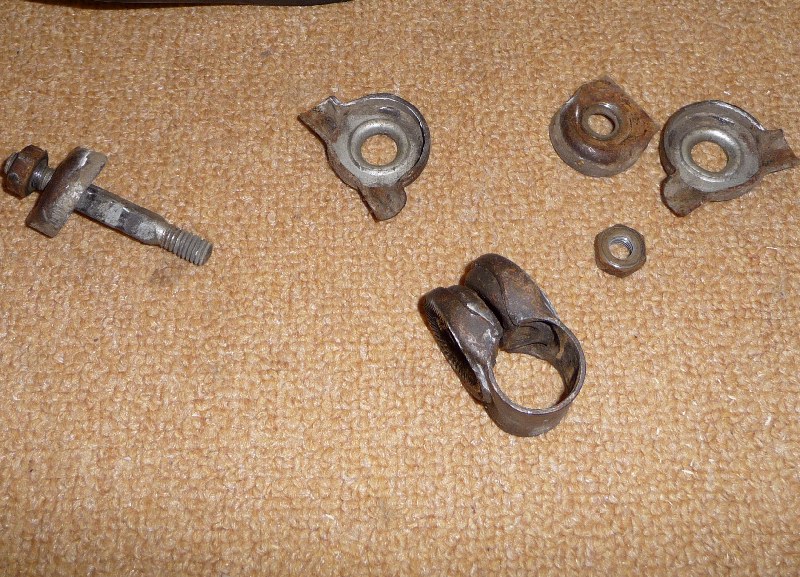

My seat guts are in a far worse condition than yours, and have decided to try vinegar to remove the rust.  The vinegar I have bought is a pickling type and therefore more acidic than regular sarsons.  It comes in at 6% acidity, and I cant see the lemon juice being more acidic than that (correct me if wrong).
Being that the effectiveness of the lemon juice is based around the acidity, I think vinegar should work just as well.
I'll let you know how it goes.

its all about the white vinegar dudes ive tried everything and nothing ceans as good, got my 88 master soaking in it now and its looking luvely  :daumenhoch:

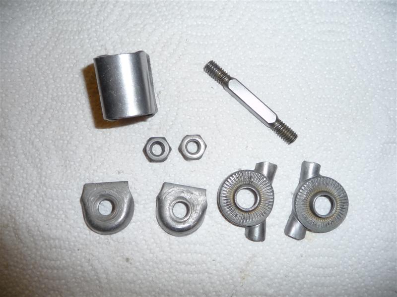

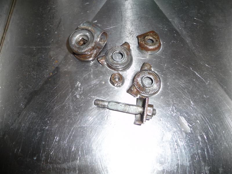

Well I now know mine arent Kashi guts despite the fact I got them on an old Kashi seat.  Still I only paid a fiver all in for it, so not too disappointed.  Them not being anything special I didnt give them the proper polish treatment, the way they look in the after pics are literally how I pulled them out of the vinegar with just a quick rinse and wipe dry.
As you can see, its worked.  24 hours in the Sarsons and the rust just fell off. It was all collected as little flakes in the bottom of the container, and anything that remained in the guts just wiped off clean.
Best bit is the vinegar only costs £1.40 for a big jar at Tesco.  ;)
Heres the before, during and after pics...
