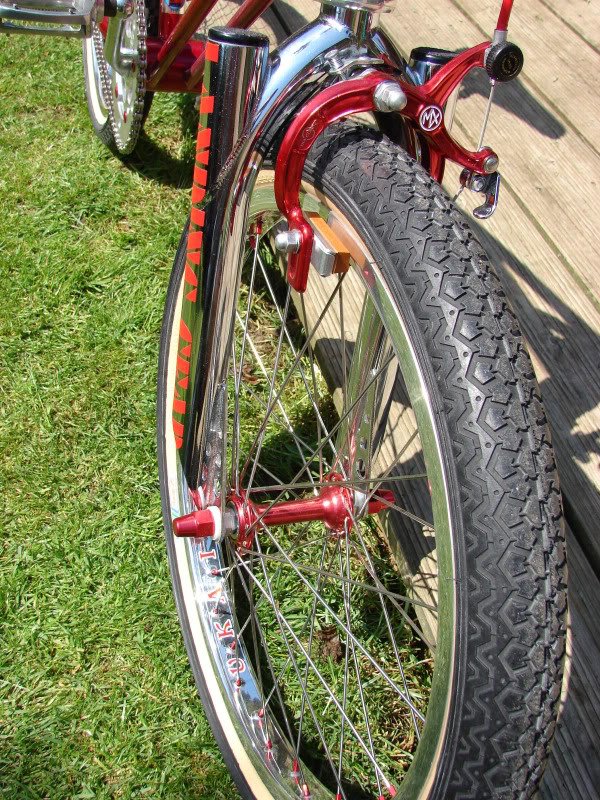

these ones mate
« Last Edit: June 16, 2009, 07:06 PM by trasher »
Re: what spokes ,,help
« Reply #10 on: June 16, 2009, 09:05 PM »
Thought it may have been those beauties.  Really loved lacing them up.
Check the spoke length though mate, If I recall they are 186mm on the front and 184mm on the rear with a 3x lacing pattern.
trasher
« Reply #11 on: June 16, 2009, 09:18 PM »
they are splendid mate ,,,top lacing job  :4_17_5:
just got the tape out ,and think your right with them measurements
i.v just ordered some 194 spokes ,,the same as i took out of a  wheel i had ,,,,what configuration would i do with these ,
this lacing lark is so confusing  :uglystupid2:
