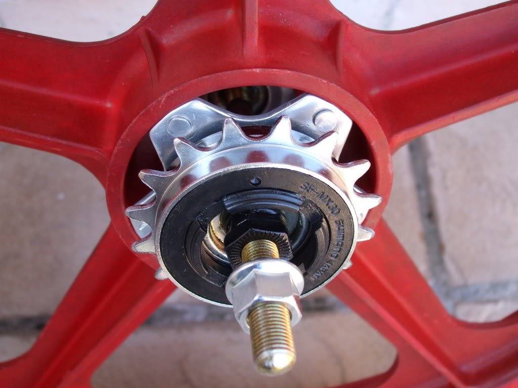

ive done a few wheels now...turned the rivets myself and formed one end then peened the other ends over with a hammer..there not goin anywhere..heres a couple of pics.
Re: Skyway Rivets
« Reply #9 on: June 24, 2009, 06:38 PM »
Good job Soll
barron
Re: Skyway Rivets
« Reply #10 on: June 24, 2009, 07:40 PM »
Nice one, I'll try to find a former/rivet snap and file the end if dome, cheers chaps!!!!
