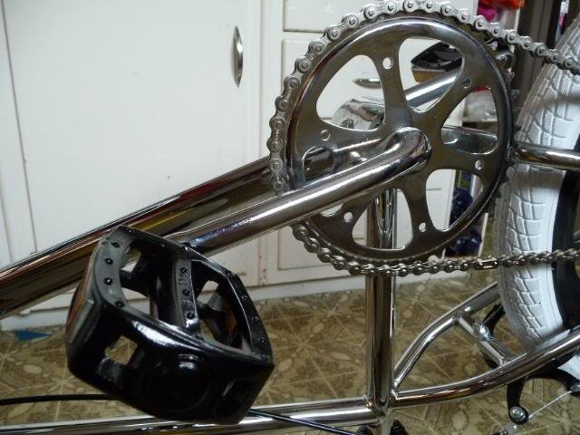

My bike is a 83 piranha and noticed a slight bent crank arm and not running true, so I just wondering what crown or spider set would people think I should use with the old style Cro-mo's? Does anyone know if they are hollow or just moulded as one solid crank piece?
Plus will I need any spacers for a three piece set Arms, Spider & Crown?
This is what I have at the moment.

One question can I stick my old 44t into a sugino one piece?
Offline oberonspacefruit
  • Posts: 24549
Re: wanted to swap out my old 1 piece crank for a Sugino Cro-Mo
« Reply #3 on: July 27, 2009, 10:02 AM »
you should be able to. there is a large flat sided nut on th back of the chainwheel, that acts as the bearing run too. That need to come off, then the chainring will come loose. Most 1 piece chain wheels that I have seen, have the same internal diameter hole, i'd be very surprised if it didnt fit.
