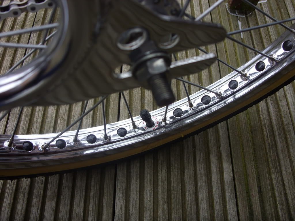

I'm after something with the same consistancy as a proper Pro Class Rim tape.
Something that looks the part and does the job.
Metallic tapes are quite thin and bulge out like the woman with the big bulgey eyes!!
I'd want a few different colors!!
Any ideas?

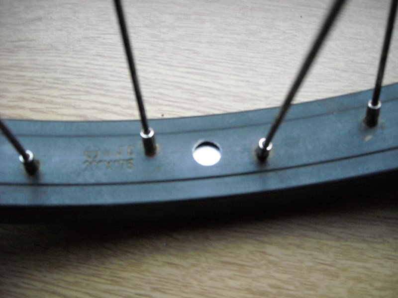

I'm using some metallic tape with the cardboard backing still on...........plus some electrical insulation tape and a proper rubber rim strip.
The trouble is its still bulges out too much with 50-60 psi behind it and looked a little to flimsy.
I was wondering if anyone has found a better alternative.

have used lats from an aluminum blind before its about 1/2 mm thick so bends round the rim well , cover with gaffa tape to keep it in place and protect the tube from getting nipped , can be sprayed to the colour you want and cos its alli you don't get any bulge
pm moley if you want some i got miles of the stuff
