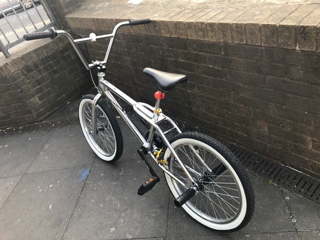

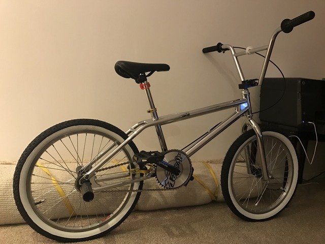

Hi guys sorry not been on here for a good few days
Excuse the rubber thingies they are lights lol had them on at
Night today
I made a video of me riding and you can hear the crank crekaing I'm sure you will know exactly what is happening trying to upload it to Photobucket but it's not happening

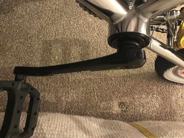

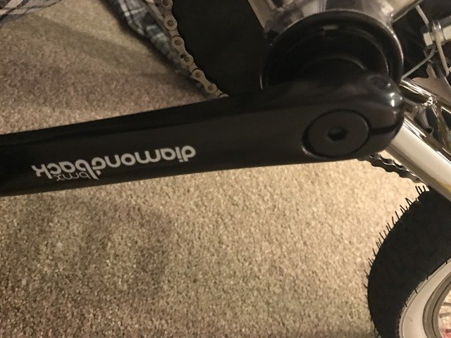

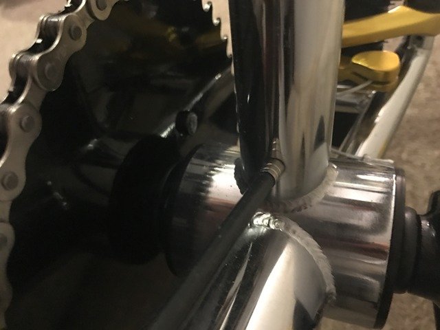

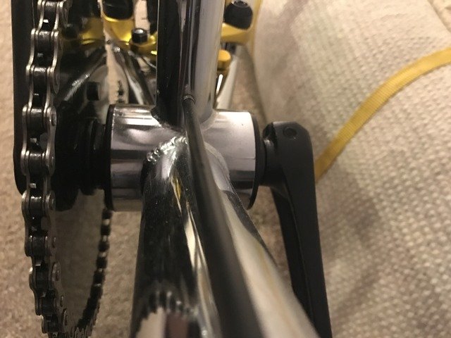

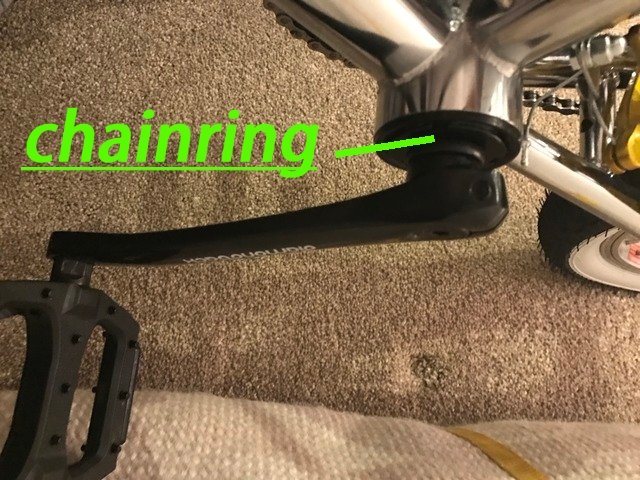

Hi thanks for explaining I've attached the pictures for you
Halfords put the bearings in for me as I was having trouble getting them in and even they had trouble
But the splines might need greasing as they don't have that much on them
Is this gap normal ?
Offline oldtired
  • Posts: 2533
  • Dirty Old Man
Re: My New Mid School Bmx Frame and other bits the build begins
« Reply #105 on: April 22, 2017, 08:34 AM »
thought so  you have put the bottom bracket together wrong!    and is potentially dangerous !  you have the bottom bracket fitted backwards!!! take it apart now!!
sorry to be abrupt  , i thought this was the problem to begin with ,        easily done with components you are not familiar with and tbh i have seen this done before i'll dig one out and post up pics of how it should go together  :daumenhoch:
bottom bracket,       if you need pics of one in a frame lmk i'll put it in a frame, if you put it together correctly the chainring will not come off without taking the bottom bracket apart , the drive arm can be removed ,you will not need the top hat washer,
 you must have problems with chain alighnment too?  the chainring may be a little loose on the axle  as it it already damaged a little, however if you tighten up the race nut well (nut with big notches) it should not be to bad don't forget the big washer or the chainring will hit the bb cups, first pic.
did you get a fitting instruction sheet with the cranks ?
driveside  chainring side
non drive side
turn the axle round this should be on the drive side, (pic below)
« Last Edit: April 22, 2017, 01:52 PM by oldtired »
