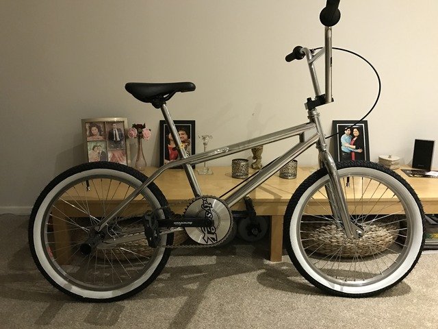

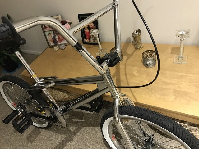

Received the top hat and the dyno stem  thank you very much Spen
It's much better now but has a tiny bit of play in the disk chain slightly tightens up I'm going to ride it to work tomorrow hopefully I will be able to live with it managed to change the stem too, took the reflectors off and straightened the bars. Is the stem ok the way I've tightened it

Abid that looks great mate. Just make sure the top of the stem is parallel with the base and really tight fistblump
Back to the chainring wobble, I assume it now moves side to side slightly, not up and down as it was before - if so the chainwheel is possibly fractionally thinner than the recess on the top hat washer and could need a bottom bracket washer to help it sit tight. Let me know and I will post out one to you to finally sort it mate :daumenhoch:
I forgot to say earlier this bike looks great now. Yes eventually change the tyres but only for final looks. Just get it ridden and enjoyEd now the better weather is here :coolsmiley:

file/grind  the inner of the top hat so it is a little thinner than the chainwheel , this will sort out the side to side movement , you may not have enough room on the spindle to add a spacer washer,  as the spindle length is set on the driveside
  as to forwards backwards movement , i've noticed the crank set has a peg for the chainwheel ,  this looks as though it is a machined bolt , or a threaded peg with a lock nut,    see if it comes out, you could make a spacer (washers) or use the locknut if thats what it is, for the outer of the chainring then  use a bolt to hold the chainring to the arm ,  it's most likely an m8 or m10 thread , m10 is a standard crank arm bolt with a allen key head,     reason for this is you may find the hole in the chainwheel will stretch out over time increasing the movement issue , older one piece cranks caused the same  issue
i know you have just bought the crankset but put on the list for the future a change to a tubular cromo crankset , will have a few advantages     will be lighter, stronger and have a bolt in the arm for the chainwheel ,
