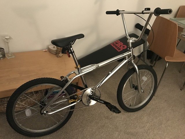

Yeah I have to say I agree. Those CW bars don't look good.
Try and get higher rise bars if you are tall. I'm 5'10 so I go with 8.75.

Please get rid of those bars ... I know all the 'build what you want' crap .. but this is the Mid School section so please ... put some mid school bars on it ... they are mid 80s bars on a mid 90s bike.
for £20 .. these would look 100000000 times better
http://www.ebay.co.uk/itm/BMX-MONKEY-BAR-TYPE-FREESTYLER-HANDLEBAR-SUIT-MODERN-OR-OLD-SCHOOL-BMX-/182469888085?hash=item2a7c0d8855:m:m-Mzg0W_e163Hmk2AUrd55A
even these
http://www.ebay.co.uk/itm/BMX-PRETZEL-TYPE-HANDLEBARS-IDEAL-DYNO-GTS-OLD-SCHOOL-FREESTYLE-BMX-BIKES-/391704675038?hash=item5b336b02de:g:G9kAAOxy63FTAdQv
Hi Ed will defo replace them once the bike is all up and running I did not know what type of bars they were came as a package
but I do like the ones in the first link cheers fella

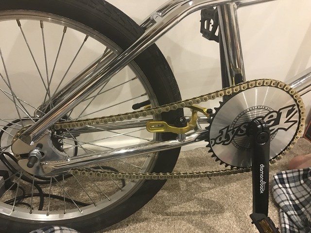

I've done a bit more on it
washed the wheels in the bath lol, changed the sprocket,
for the life of me I could not split the chain I was going mad at 2am
even with the tool I'm going to take a trip to halfords after work
need to fit the tyres you sent me

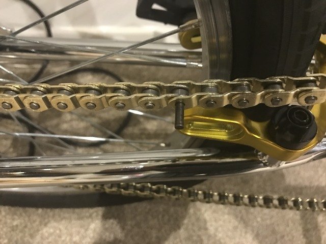

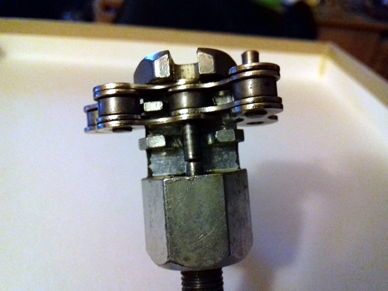

Hi guys a have a problem the tool wont push the link in and I don't know what to do
i've been pulling my hair out trying

Wind the tool right out, turn it round on the chain so the pin is inside the tool and move the chain over to the next notch and it will wind it back in for you.
When you get it in far enough, go a turn further then turn the chain round and undo the tool one turn. It will free the chain up so it doesn't kink.
I'm back home later so will see if I can sort the top nut and washers out for you :coolsmiley:

make sure the holes are lined up before pushing the pin through , half link chains are prone to cracking around the pin hole as you push it back through
you need the tool like this to push the pin back in
Re: My New Mid School Bmx Frame and other bits the build begins
« Reply #37 on: March 17, 2017, 11:16 PM »
...or mole grips to get it most of the way in ... then chain splitter to finish it off  :)

took the bike to halfords last night and they couldn't push the pin in I couldn't believe it he tried and damaged 2 tools
they ended up putting a standard chain for me and gave me another replacement gold chain I think they did not have a proper tool for the half link chain
I was so gutted at least it has a chain on now

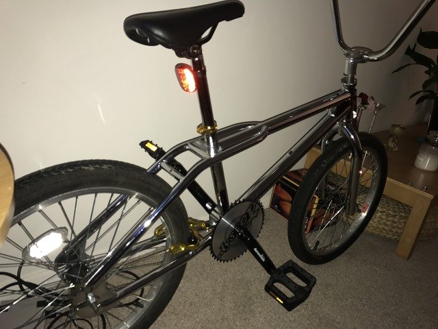

you guys are not going to believe this for the life of me I could not get the back brake to work
thats the only thing stopping me riding the bike, oh and the fork lock nut
excuse the brake pad missing I know that lol but the caliper on the brakes is not working I'm not use to a U brake searched on youtube but still no joy
cheers guys

With the U brake, as quickly and easily as I can explain it. OK, there is a spring pre loaded into each "arm". So what you need to do is put an allen key in the bolt in the middle, then put a spanner over the body around it (you will see it is shaped to take a spanner). You tension up the spring with the spanner (so that the brake springs away from the wheel) then do up the middle bolt which locks it all into place and keeps the arms under tension.
And that's it really. Repeat on each side..

cheers Andrew I will give it another go mate nice one thanks to you the bike is looking like how it is
cant decide on these 2 links mate both are nice what do you suggest
http://www.ebay.co.uk/itm/162274140706?_trksid=p2060353.m1438.l2649&ssPageName=STRK%3AMEBIDX%3AIT
http://www.ebay.co.uk/itm/182469888085?_trksid=p2060353.m1438.l2649&ssPageName=STRK%3AMEBIDX%3AIT
« Reply #41 on: March 18, 2017, 05:17 PM »
The 4 piece bars would be much more in keeping with the frame IMO
