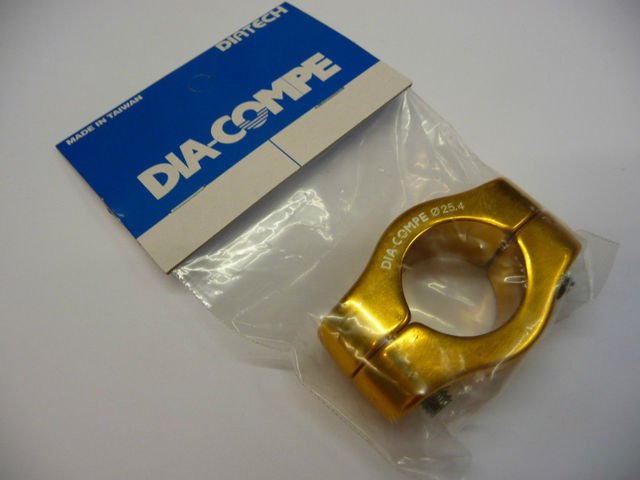

Hi Guys My Name is Ace (Abid)
Grew up in cricklewood then moved to Wembley in early 2000
back in the day mid 90's had a good few BMX's
my favourite one was a Freestyler in chrome with build in stunt pegs on the front forks
and on the rear lower frame, along with black mags and gold brakes omg those were the days I use to ride everywhere and be out till late lol now I'm going to be 35 this year

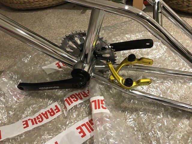

this bike frame has a brake which needs to be fitted at the bottom of it and is that some kind of a special brake i'm looking for would prefer it in gold if possible before I order those shiny gold levers
thanks chaps

I don't think that seat clamp will fit fella. It says 25.4, which is the post size of your bike, not the overall frame size.
http://www.ebay.co.uk/itm/150mm-6inch-LCD-Digital-Vernier-Caliper-Electronic-Gauge-Micrometer-Measurement-/222410321533?hash=item33c8b02e7d:g:j7YAAOSwtfhYpBaY
I suggest one of those before you buy anything else. I've forgotten the clamp size you need...
OK mine is 28.6mm. Yours may possibly be the same, but get yourself a pair of those calipers any way. They're incredibly useful :)
And hey, don't buy anything else until you run it past us. I should have taken my own advice, that's why I ended up buying three bloody headsets :D

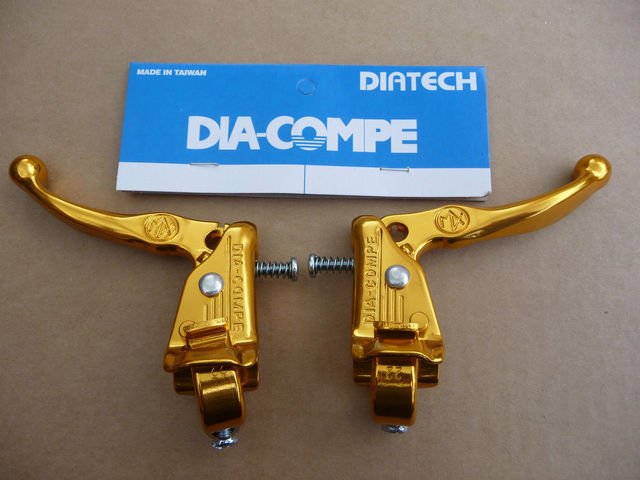

the rear brake is a "u" brake. make sure you use a lever that suits the type of brake you are using.
if you use a caliper brake on the front, it needs a standard (short) pull lever , the u brake needs a long pull lever, same as a v brake.
Yup. Thankfully I have sent him a reasonable tasteful set of black levers he can use.

no, they are v brakes. you need a u brake. as you will be running a caliper brake on the front, as the forks have no u brake lugs, you will need different levers for each style of brake. you will need a short pull for the caliper brake and a long pull for the u brake.

http://www.ebay.co.uk/itm/Coyote-BMX-U-Brake-Calliper-239g-with-Kit-Anodized-RRP-19-99-/201605642026?var=500829974680&hash=item2ef0a1f72a:g:jyQAAOSwM4xXY4Vd
There you go dude, one gold U brake with all the fittings.
V brake lugs are thinner and usually come on race bikes. They would snap if you did flatland with them for example. If you don't want a front brake don't bother. If you do?

seat clamp is 28.5mm I ordered the wrong one lol

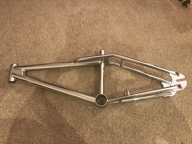

Is that one of the Cyclesport-made Standard style frames that got given away at MK a couple of years back?
Are they still in business? I could swear that's who I bought mine from in around 1998.
I don't think his frame is recent. The seller who sold it to him has a load of stuff, all from 96-99. Like specific SE parts for example.
They were in business as BMX City but the warehouse is gone and they have close down now ... they are the reason that every Facebook Mid school page is full of Sun rims for sale  :)

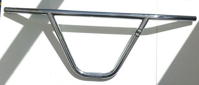

This is the frame I got ... looks the same to me ... and as Olly says, a lot like a Heavy Tools Screamer :-)
This frame would really suit some mid 90s parts ... please don't use those bars! :-)

http://bmxmuseum.com/bikes/heavy_tools/69250

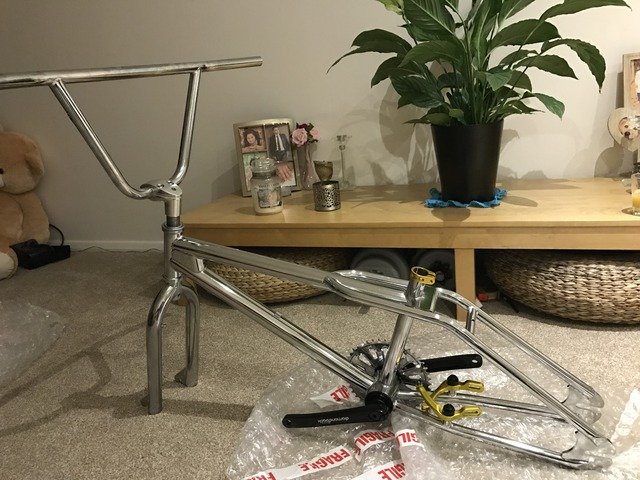

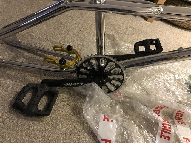

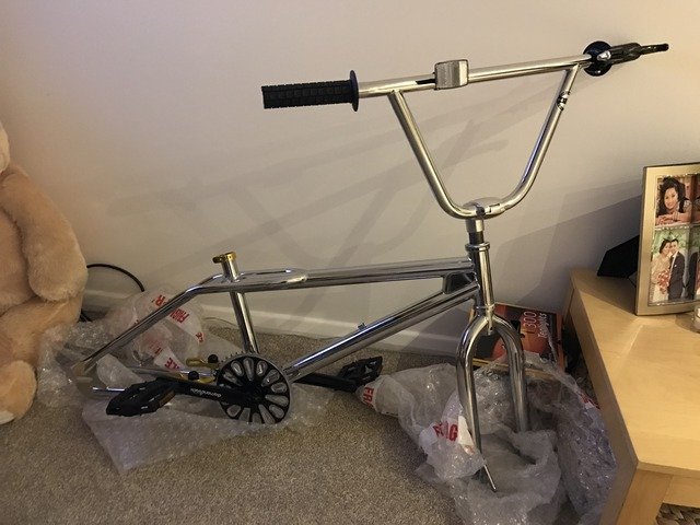

Hi Guys
this is how it is from last night
still waiting for seat post to arrive, black seat going on.
Awaiting for odyssey sprocket as I messaged a seller on ebay and he did not reply at all hence why I purchased another one which has not arrived yet. Picked up a nice gold chain from halfords they gave me a hand to put the bearings and crank in the young lad was so chuffed he couldn't wait to work on the bike.
I have a slight problem if you look at the headset I have a big gap as the lock nut has a lip which wont allow the nut to screw down fully I also need a spacer for it any pointers will be great.
can't believe it finally coming along together

« Reply #20 on: March 14, 2017, 10:43 AM »
Hmm might need cutting down.
Looking good though man :)

« Reply #21 on: March 14, 2017, 12:27 PM »
Let me have a look in my box of crap as i think I have a deep top-nut and a higher top race with a few washers that might take that spare length of thread up for you.
If that fails I wouldn't cut the threads as a first choice, but if you do, make sure you screw the top race on right to the bottom of the threads out the way before you cut. Then file the burs off the threaded area you'very cut before slowly winding the top race back off again to clear the threads up as best you can, or you may never get the threads aligned enough to rebuild it.

Please get rid of those bars ... I know all the 'build what you want' crap .. but this is the Mid School section so please ... put some mid school bars on it ... they are mid 80s bars on a mid 90s bike.
for £20 .. these would look 100000000 times better
http://www.ebay.co.uk/itm/BMX-MONKEY-BAR-TYPE-FREESTYLER-HANDLEBAR-SUIT-MODERN-OR-OLD-SCHOOL-BMX-/182469888085?hash=item2a7c0d8855:m:m-Mzg0W_e163Hmk2AUrd55A
even these
http://www.ebay.co.uk/itm/BMX-PRETZEL-TYPE-HANDLEBARS-IDEAL-DYNO-GTS-OLD-SCHOOL-FREESTYLE-BMX-BIKES-/391704675038?hash=item5b336b02de:g:G9kAAOxy63FTAdQv
that would be great Spen would save me messing about with it and thats good info   :daumenhoch:
