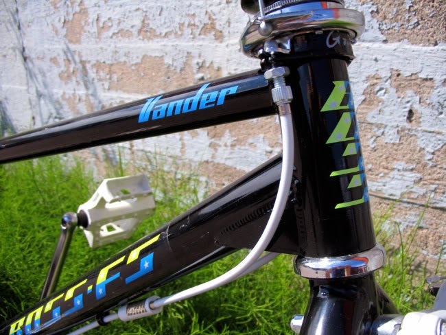

They did a Boss Vander tribute.....
Re: Vander Beat
« Reply #13 on: July 29, 2007, 07:42 PM »
thats the one i was thinking of i reckon,one on ebay at the mo.
YGT
Re: Vander Beat
« Reply #14 on: July 29, 2007, 07:42 PM »
yeah thats Timo's bike aka 2fresh.
