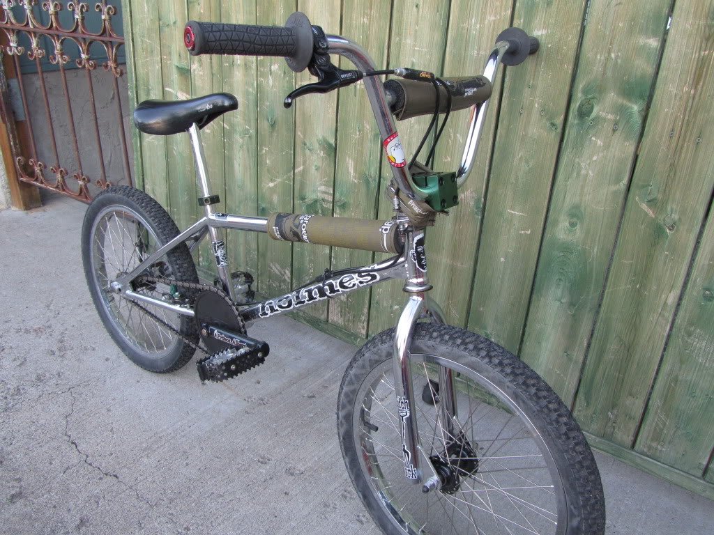

Holmes MK1 on right MK3 on left, forks on MK3 have the extra inserted tube  wedgie no workie.Hope this helps with some of the bends at steerer also.

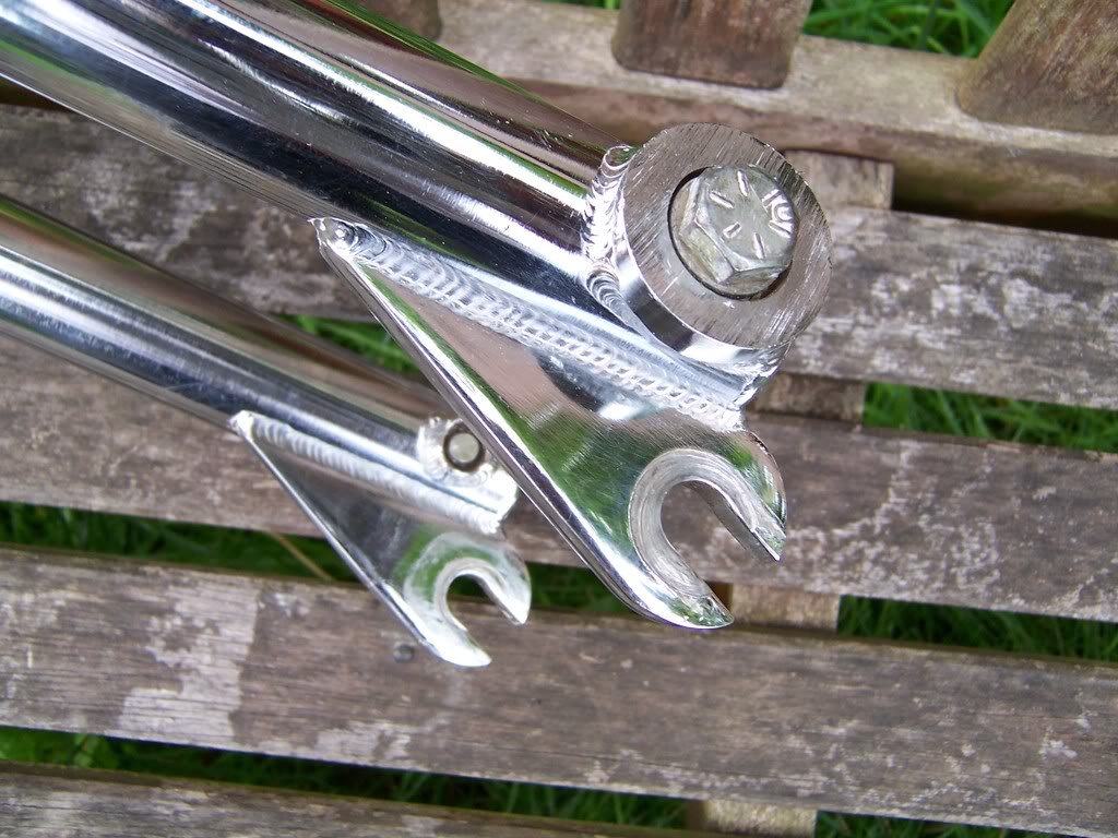

here is the second version of the stupid/menstrual fork with the wrap around dropouts.

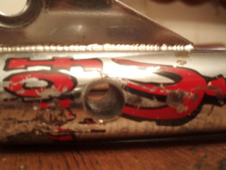

these just popped up on the museum. i believe these to be the first gen of ditch forks. were taken off a 92 murray style holmes.  has the sandwich dropouts,no visible welds on the pegboss area on the (outside of the) leg and also notice how far up the peg boss hole is compared to later ditches.
