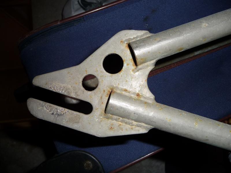

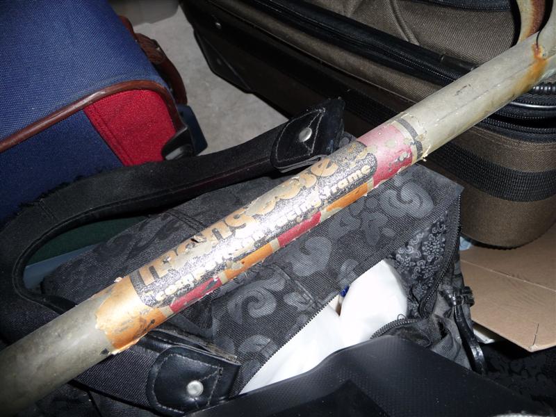

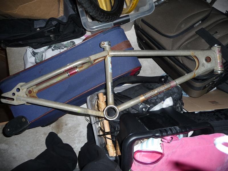

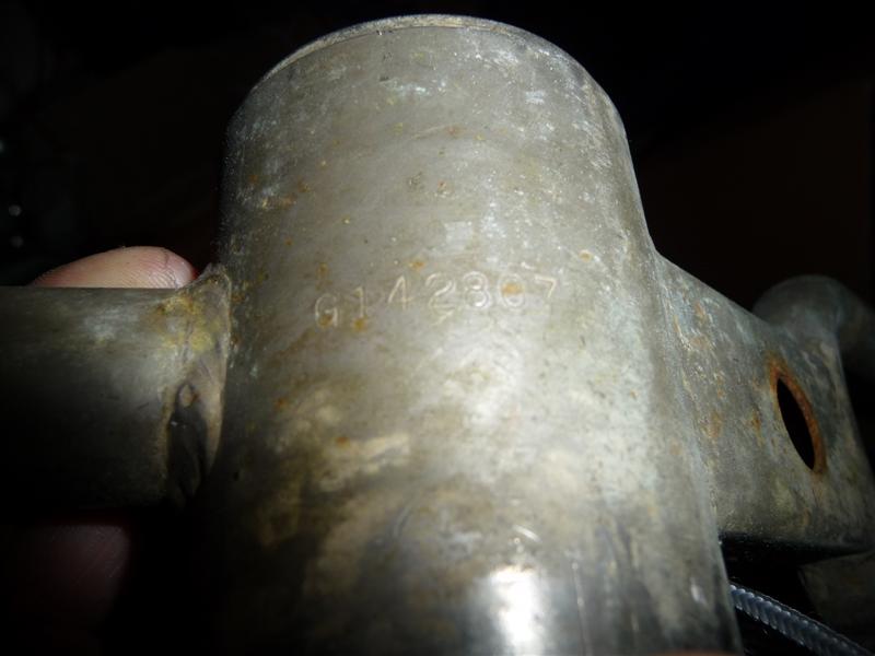

and here is one of mine.......... (excuse the mess in the loft  :-[ ;D )
she's a bit rusty as well :shocked: one day she'll get powdered but the list is long before i get to her :LolLolLolLol:
..........dropouts are 2nd gen, decals are second gen and serial No. G142807 is 2nd gen (and same month serial as paul's  ;) )

John..... just to confuse things mate  :LolLolLolLol:
Whats the difference between your frame above and my frame, they look identical.  ??? ???
They are pretty much identical mate - your one is an '83 model which has all of the 3 81 element changes on it mentioned above - dropouts / serial style / decals (once you get the decals that is  ;) ) once these changes happened in 81 this style of frame carried on through to the end of it's life in 83  :daumenhoch:
The only difference is that your serial is probably on the box section lip rather than the BB and the box section is channel rather than full box in the case of mine  ;)
Ahh yes the box section behind the BB wonder if that changed in 81 as well :-X :LolLolLolLol:
All my 82 frames are channel not box and all my 81's are box  :-\ maybe that changed late 81 / early 82  ???

Ahhhhh i can see the difference now, i didn't notice your BB section in your photo.
