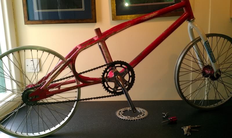

just been doing a mock up build to see what the issues are with the chain
you can see here where the chain touches the frame
at the moment the chain only just touchs the frame im thinking of heating the part up and bending it out slightly so the chain runs free but not sure yet.
big thanks to firebird steve and poolysherrif for there help so far  :daumenhoch:

If there's room, would it help if you put the chainring on the inside of the spider? ???
Re: prototype dp firebird freestyler
« Reply #2 on: May 20, 2011, 12:53 PM »
thats a bit of a quandry isnt it, nice frame though.
controversial thought here but how about having the tube indented like they do with some chainstays behind the chainwheel to give clearance to the chain, as the chainwheel and freewheel look to be inline so moving the chainwheel inwards would only make the chain run at an angle and put undue pressure on it.
Good idea

I was going to add that you should consider a smaller chainring, 36T or 38T and mount on the inside of the spider. Then try and get hold of a 13T or 14T rear freewheel or change your hubs for a Shimano cassette 14T  :daumenhoch:
Might help you get round the heating and bending of the frame  :coolsmiley:

ive almost cracked it chainwheel is on the back of the spider but ive had to use a 40 tooth chainwheel, but it has worked.
this bike will never be ridden so i guess the gearing isnt as important

you could also add another washer, about 2mm to the hub on the drive side and remove one from the other side or grind down a cone nut about 2mm to balance it out.

get in ya bastard 2mm of clearance is better than none :LolLolLolLol:
popped some tuffs on much better

 Would a thin chain be any better  ???
« Reply #21 on: May 21, 2011, 05:25 AM »
Good call, a 3/32 10/11 speed chain would be half the width!

As others have said definately try and get a washer or two on the hub axle  inside of the dropout to lightly adjust prise the frame out ward . :daumenhoch:
